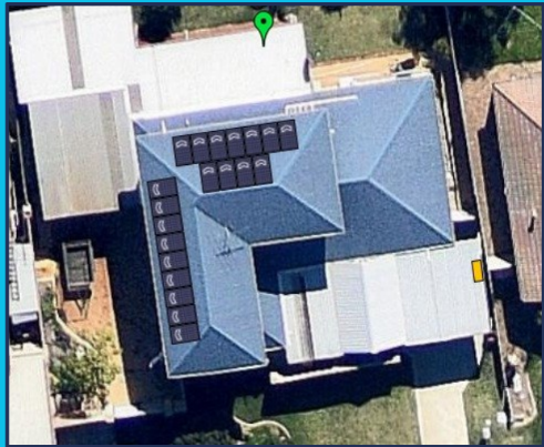

They all provide slightly differing layouts, which is a little annoying but can anyone recommend a layout that would work well in our case? I’ve attached one for reference.

Regarding layout, I think the north and west roof approach that you’ve attached makes sense. Although the installers will need scaffolding or similar on the west roof for safety, that would be quite a drop (which could cost extra. One of those things that dodgy companies don’t break to you until they arrive on the day for install). Otherwise, can you use that flat north out the back and use tilt frames? Worth getting into the detail of that once you’ve established which company you want to work with.
