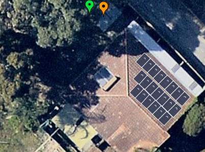

Following up with actual quotes from companies who visited today. All three companies noted more shading from the ariel view of the house then we noticed on the ground. (Am I ok naming companies?)

installed spit over north east and north west sides of the house

21 x Jinko Cheetah 315W Mono panels or 20 JA Solar 330 W mono panels; fully optimized (all on the north east side, no need to remove hot water heater)

Jinko Cheetah 330W Mono panels (all on the north east side, no need to remove hot water heater)
