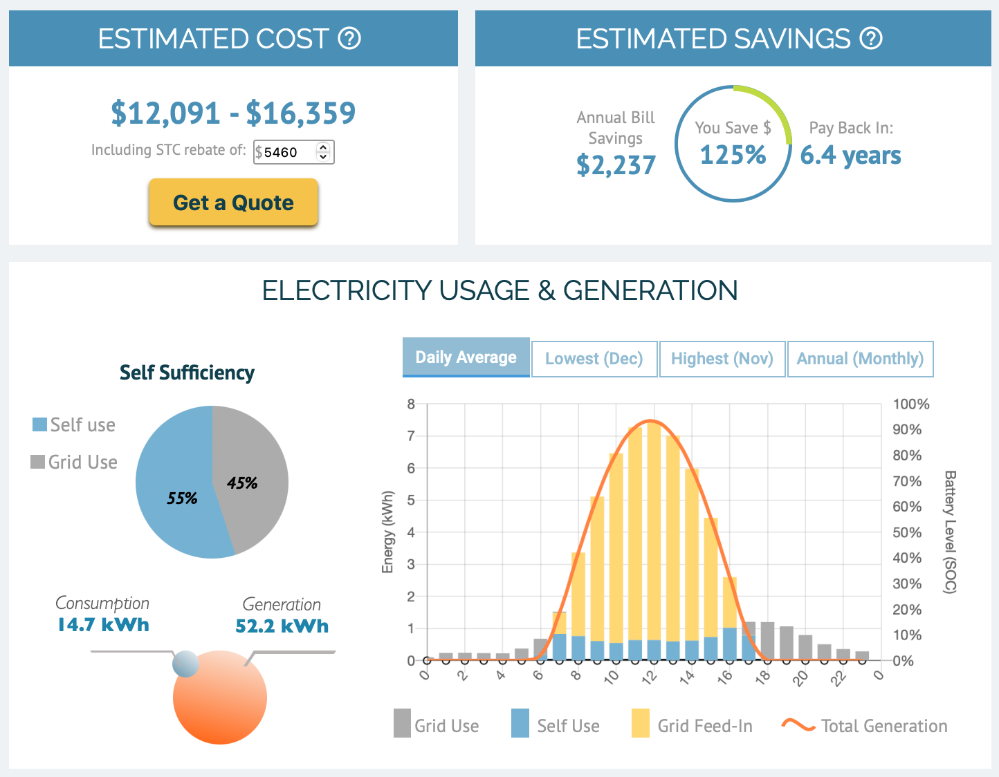

Hi @jmeikle
Ok well looks like this system would tick those boxes. According to our Solar Simulator you’d cut around 90% of your bill out. It’s a quality system. You might be able to do a bit better on ROI if you got that price down a bit, but if they are a really good company then it’s probably worth it.
