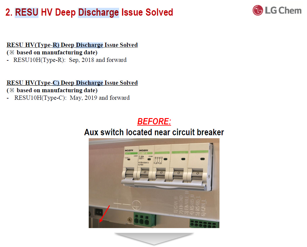

Are you aware of this information? LG Chem had to add an additional BMS controller circuit breaker in late 2018. I’m guessing your battery doesn’t have this switch added?
Wow, thanks, that’s useful to know! My battery was installed before late 2018. But I’m not sure whether that is the issue, or whether the discharge was too high or too low.

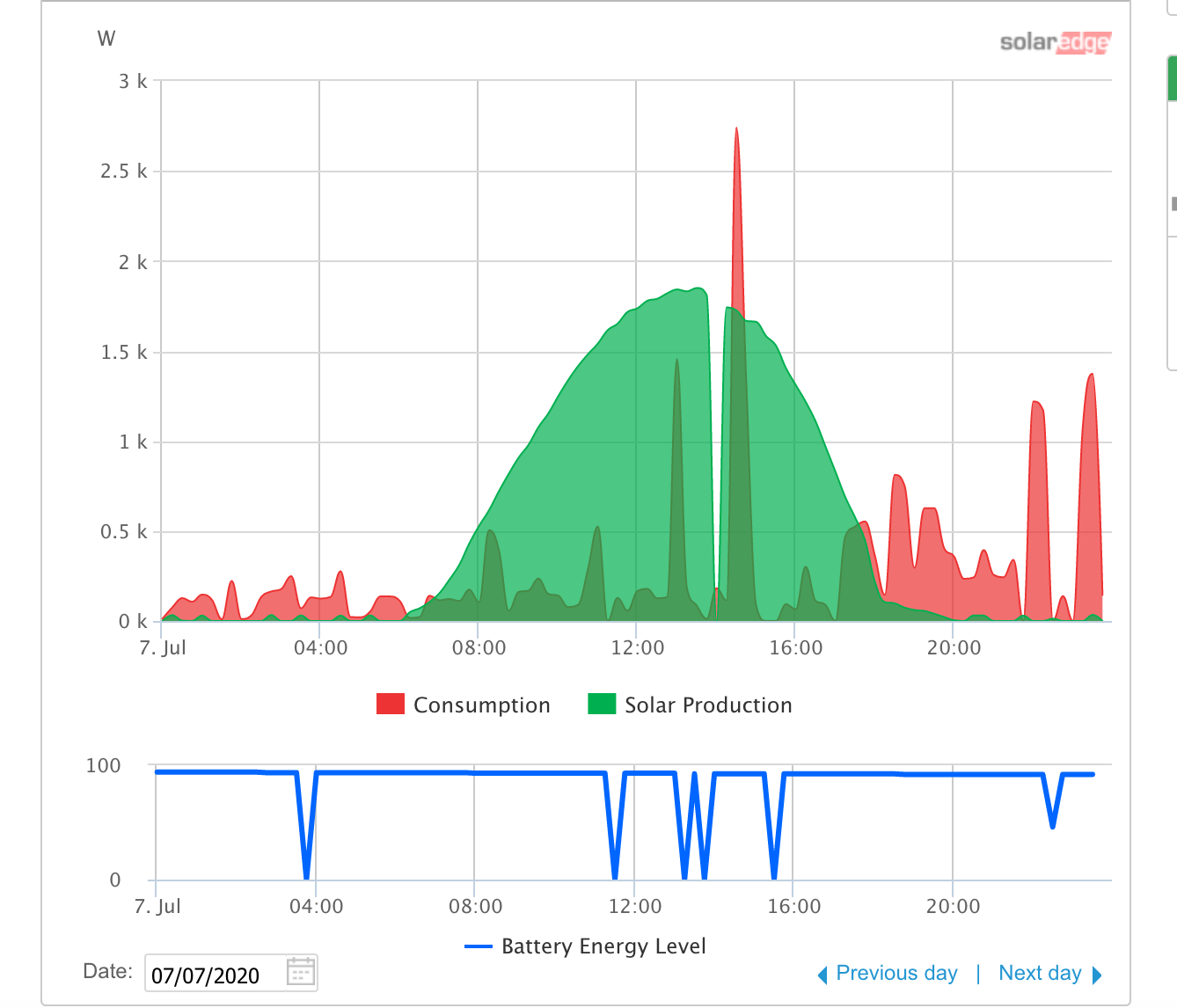

I can say, though, that the first sign of a problem was that the internal circuit breaker tripped. SolarEdge alerted me, I restarted the system, and the battery seemed to work for a few weeks before some weird cycling behavior set in. Here’s a screenshot from SolarEdge monitoring during the period:
