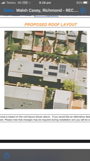

5.2kW total system. split into 2 strings, one east and one west (both on a north facing flat roof with 20 deg pitch) so that any shade thrown by a vent in the middle (on shade analysis will effect one panel on each side before 9am and after 3:30pm in winter) will not heavily effect the rest of the string.

Hi Marty, I’ve attached a screenshot of the roof layout.
Tilt is 20 deg. This installer charges, one we spoke too didn’t.
Wiring could be difficult to switchboard, and the recent quote was the only one that actually looked at how they would be able to get to the switchboard.
Not sure if blowing smoke or a genuine concern. However most of cost is in the panels and inverter.
