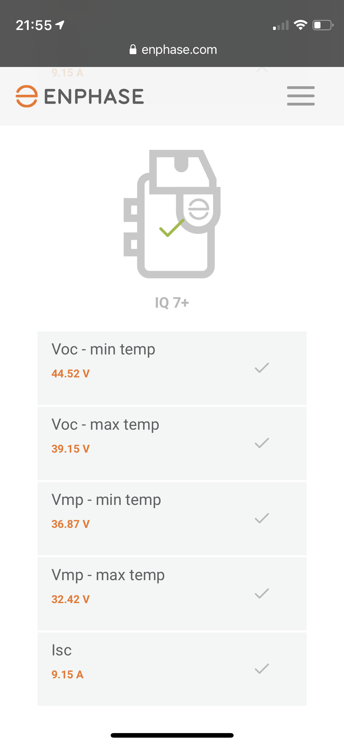

There is the Enphase Compatibility Calculator, do you use that?
This is the result for the Trina 370W you mentioned @BrownBird:
This shows it’s compatible with IQ7+, as well as IQ7, but not IQ7X. You would go with IQ7+ as suggested by the installer, and IQ7 would ‘clip’ (ie restrict) the amount of solar your could produce.
While the formula will tell you if the panel will work with the micro-inverter it does not indicate how well it will work. I have used it to determine if the panel will work but fall back on my determinations as to how well it will work for the client. I only use the compatibility calculator when the panel is not listed in my software from Enphase as a designated panel. As you indicated the Trina 370-watt will work with the IQ7+ (and will work with excellent results), however my information is that the IQ7 is not designed for 72 cell panels and the recommendation is to only use them on 60 cell panels. Now, we accidentally installed a 72 cell system with the IQ7 and it worked, but the modules were not covered under warranty because we were exceeding the system parameters (realized the mistake and quickly replaced all IQ7 with IQ7+). Again you also have the different outputs from the micros the IQ7 will deliver max output of only 250-watts while the IQ7+ will peak at 295 watts. The Trina 370 is in the exact sweet spot to maximize power production and minimize power losses when matched with the IQ7+.

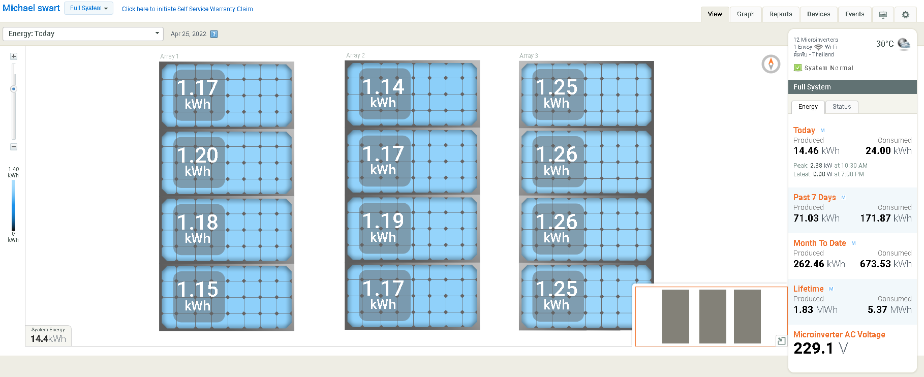

I live in Thailand , and i have 12 Enphase IQ7+ inverters in a single line. On a flat ground installation
I am using 12 x Trina solar 445W panels
I have been using this for about a year, and have had no issues what so ever.
Below are screenshots of the individual panel production for the day and a graph for the day - till 19H30 current time.
Unfortunately it is not possible to get the Enphase Batteries here in Thailand - so i will open a seperate thread for advise on setting up a seperate 5KW system just to charge a Huawei Luna - 5KW battery to use at night and for power outages.
Thought i will share my experience with using over 400w panels with Enpahse IQ7+
@royalmice Thanks for the data. Do you know the reason why the panels on the left are producing less power than the panels on the right? Is there more shading on the left panels?
HI @Svarky
This is a ground installation, the panels on the left are on the low end of the slope, the panels on the left are also 2 years older and different brand than the ones on the right.
Low end start at 2m and the high end is 4m high there is a big fence infront of the low end, so they get the sun a little later than the high panels

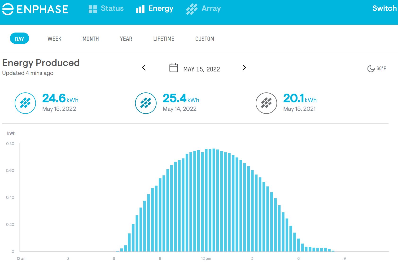

I am seeing a flat curve production with my newer IQ8+ based system, a “flat top” energy curve.
I believe I should have had an IQ8M, A, or H, version installed instead of the IQ8PLUS IQ8+ in order to avoid clipping.
I have another home with the IQ 7 based system and I am seeing a perfect sunlight curve. See attached pics.

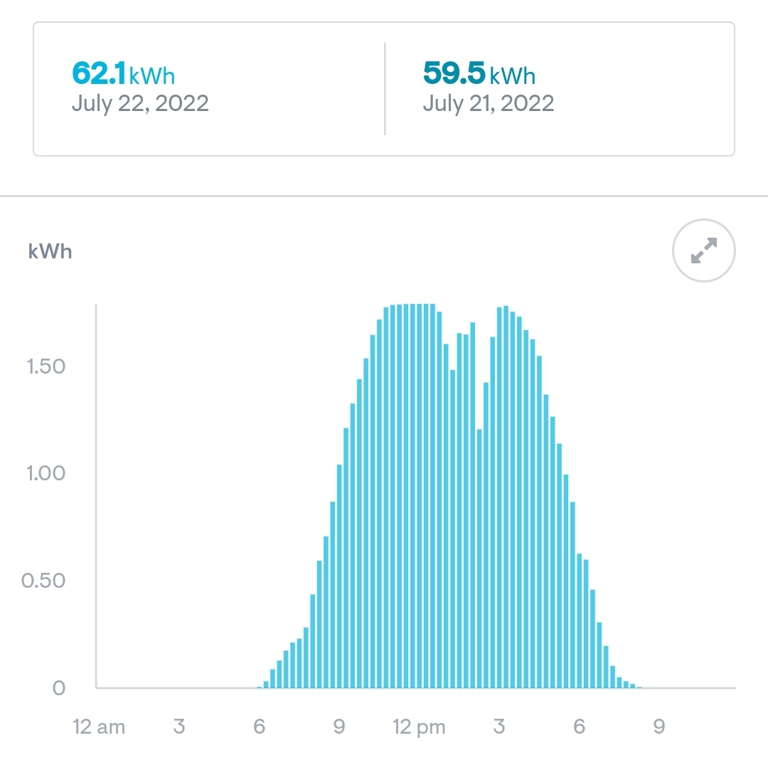

Our south facing residential system in Southeastern PA with 24 CSI CS3W-450MB-AG bifacial panels and IQ8plus-72-2-US inverters was just switched on last week. 10 panels are on a second story roof and 14 panels form a first floor roof over a deck. It was originally going to be QCells bifacial panels, then Trina, then something else, but finally landed on CSI because of stocking and availability issues. IQ7+ inverters were going to be used but they were also out of stock which forced the upgrade to IQ8+. I had asked if these were sized appropriately, and our installer assured me they were.
Anyway, the Enlighten app shows the system output clipping at 7.2kW, which happens to be the peak 300W inverter output x 24 panels, so there is still some production being left on the table. Here’s a screenshot of the production today, which came in at 62.1kWh total. Today was also pretty hot in the mid 90s. The temp sensor above a door but below the panels on the deck peaked at 105F.
Are the IQ8+ inverters appropriate for this system or should they have specified the IQ8M/A?
