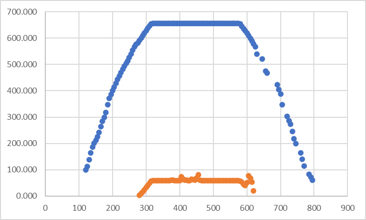

I downloaded the recent production report which has data for every 5 minutes from the past week, and plotted it using Excel. After removing the ramp up, ramp down, and plateau data points I applied a best fit parabola to see what extra production the system might theoretically be able to produce on a clear day. Turns out that it could potentially produce an extra 7.5kWh! That’s 11.8% of the 63.7kWh that the system produced that day which is a bit more than minimal…
And just to make sure this is possible, here are some additional numbers.
The peak steady state output was right around 7200W, which for 24 panels is 300W per panel or the maximum output of the IQ8+ inverters.
The 450W panels are rated for 338W nominal max power at NMOT, which is 8112W for 24 panels. That number is only 1019W shy of the theoretical 9130W peak from the best fit parabola. Factoring in the 97% inverter efficiency and the production might be capped at something more like 7880W. That translates to an additional “real world” output of about 3.85kWh (assuming I did the math properly). That makes the IQ8M (325VA max continuous) the better inverter choice because it could extract max power from the system. The IQ8A (349VA max continuous) would also be fine even though it’d be slightly overkill.
This is really useful insight, and indeed >10% clipping is more than minimal.
I can’t understand why Enphase doesn’t do a better job of giving users and installers tools to not just understand which models are ‘compatible’ but also which models will perform the best.
I find it hard to recommend Enphase based on improved performance when this level of clipping can occur.

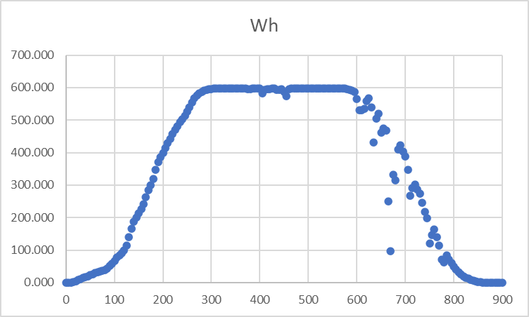

It’s obvious the system is clipping at 12.5 kw which works out to 291kva (12500/43) per panel.

I calculate clipping loss at 28%!
