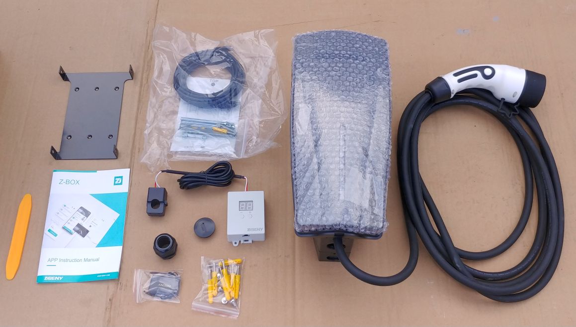

I thought I’d share my experience installing a ZJ Beny EV charger. This is by far one of the best value ‘smart’ EV chargers available at only $675, including one CT clamp.
Overall, the charger appears to be well made and comes with all the accessories to enable load-balancing using the DLB box (included).
One frustrating thing is that the PV (solar-only) charging feature requires a different Solar DLB Box, as the standard DLB which comes with the unit is non-directional and only works with basic load-balancing. I’m in the process of ordering the solar DLB unit.
The plastic front cover is quite thin and just snaps on, but it looks great once installed.

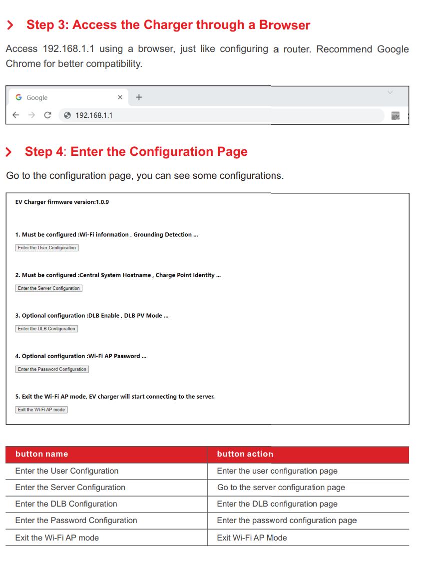

Are you able to check whether the OCPP server address is configurable (this would allow the use of a custom server/app rather than the ZJ Beny default).
The configuration for it probably requires navigation to the charger on the local network once the charger is connected to WiFi. If you can navigate to it by entering the ip address of the charger in your browser and report back you findings it would be much appreciated.

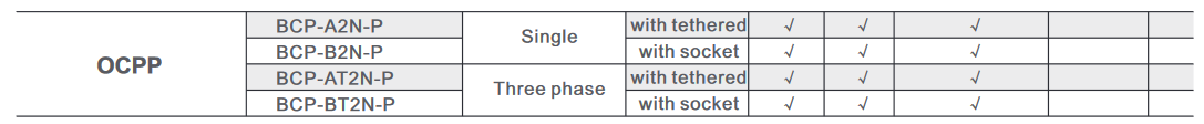

@Nef, I do not have the OCPP settings on my app. I have the smart DLB model (BCP-A2N-L).
OCPP is optional, so you have to order the specific model with this feature…

Yeah, I was wondering/hoping that the models with L at the end (which are more widely available) were actually just preconfigured P models with the OCPP server pointing to whatever ZJ BENY’s app uses.
Did you happen to see what comes up when navigating to the charger on your LAN through a web browser? (note: it probably doesn’t have 192.168.1.1 as its LAN IP address like the screeshots below show)

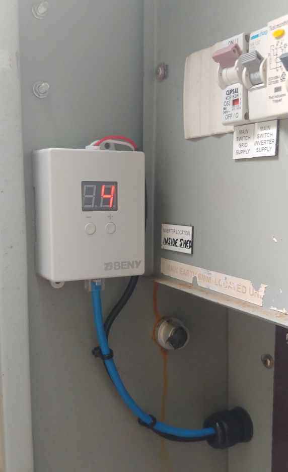

Here’s the DLB box installed in the meterbox. As mentioned earlier, a separate (optional) Solar DLB box and additional CT clamp are required to enable the solar charging modes. The normal DLB box comes with one non-directional CT clamp and cannot be used to enable solar-only charging!
One bonus is that the DLB box is powered by the ethernet cable connected to the charger, so no power connection is required in the switchboard.

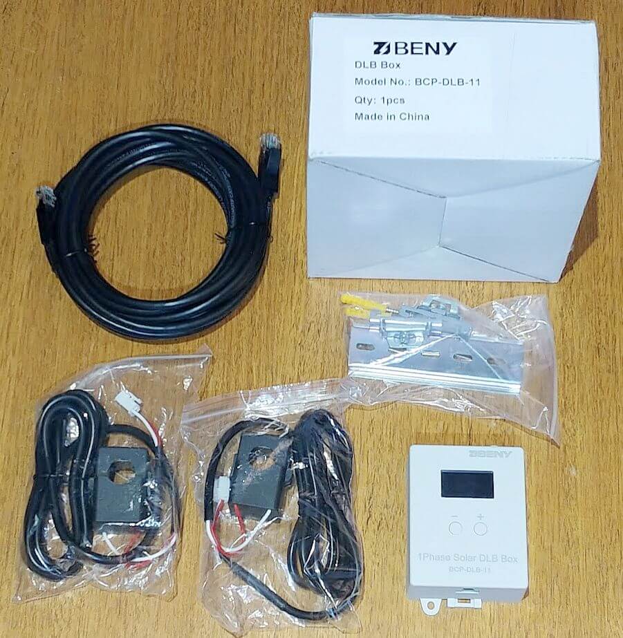

I received the Solar DLB Box on the weekend. It costs $155 inc GST, and here’s what’s inside the package - The Solar DLB box, din rail, network cable to connect it to the charger, and 2 x CT clamps, one for solar and one for the main house loads. (Although, the ZJ Beny charger comes already comes with one CT clamp and a network cable, so now I have some spares)
This is the single-phase unit. I’m not sure how the 3-phase unit would look as it would need a total of 6 CT clamps, 3 for the solar, and 3 for the loads?

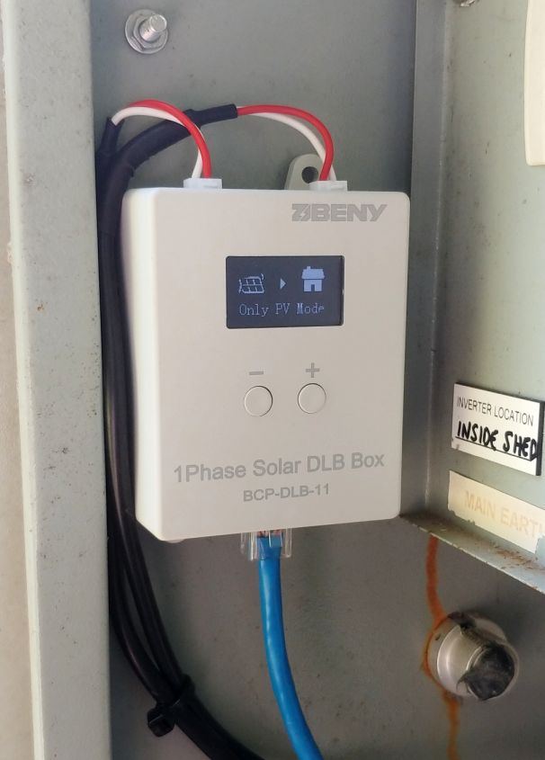

Here’s the Solar DLB box installed (There were no instructions). It’s a little strange to use as the settings start from the “Only PV Mode” then go into “hybrid mode” which you set the current limit from 1A all the way to 99A. Then, after you reach 99A, you can finally select the “Full speed mode”.
Unfortunately, I haven’t been able to get it work as I keep getting an error and the Charger enter fault mode saying that the CT’s are not connected correctly (even though I doubled checked them several times). The problem may be that the CT clamps that come with the Solar DLB are different to the CT that comes with the charger. I just used the existing CT clamp from the charger as it was already installed and I noticed the red and white wires were in opposite. (I’ll double check the CT model numbers tomorrow). It’s very strange if they are different and will no doubt cause a lot of confusion.
UPDATE: See the setup wiring diagram shown later in this comment threat. The CT clamps need to be installed in an unusual configuration.

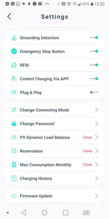

Can you lock and unlock the charger using the app?
Do you have the CT connected after your solar joins the mains power, so you’re measuring total consumption including solar?
(I ask partly because this looks to me to be a difficult thing to do in a typically wired Oz fuse box.)
You can turn off plug and play. I too don’t have an EV yet, 6months wait became 13 months, so I don’t the actual effect of this. However there doesn’t appear to be remote access via the App, you must be on the same Wifi or using Bluetooth.
Interesting… The datasheet shows that the charger has Wi-Fi connection so it should be able to be controlled remotely.
also, what EV car are you getting?
@D05HY yes, you can lock and unlock the charger using the app. There is a setting called “Control charging Via App” so you have to use the App to start and stop charging.
However, what @Michael_D said is correct, the WiFi and app will only work if you are connected to the same WiFi network as the charger. (It doesn’t let you remotely control the charging process from another location)
