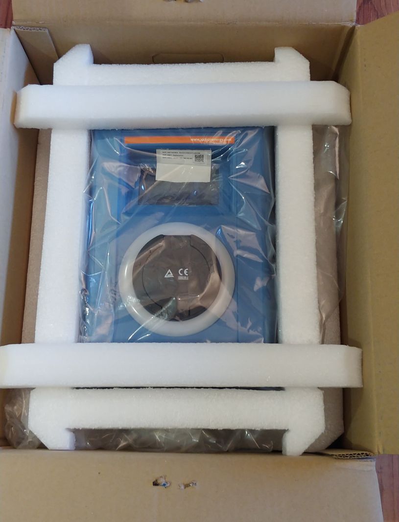

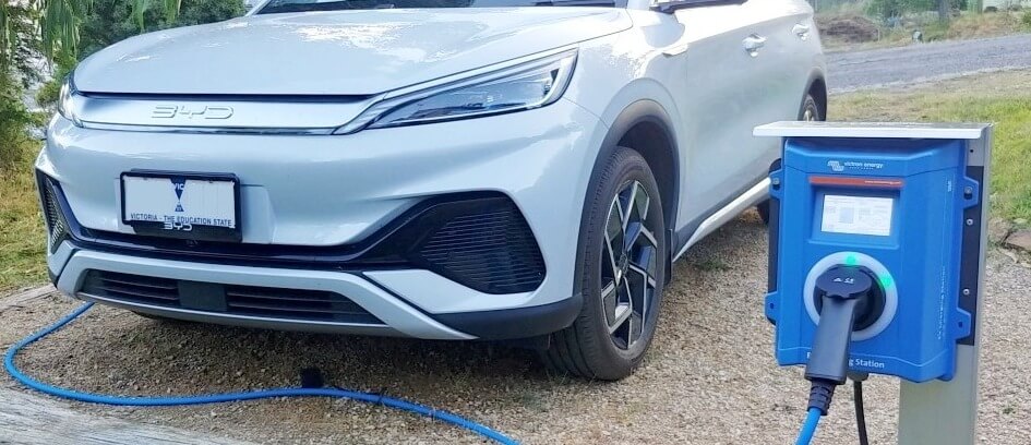

I’ve purchased a Victron EV charger to charge an EV using my off-grid solar system. It should be installed next week, but for now here are some snapshots.
Not much in the box except the charger. No mounting plates (since it uses side screws) or a manual (online) and no charging cable since they only offer a non-tethered option. Although, the colour touch screen display is very nice.

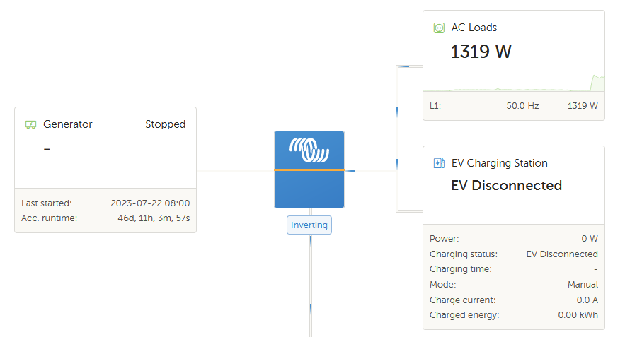

The software is the most important part of this charger. It fully integrates with the Victron VRM system and can be controlled and monitored through any GX device and the VRM. (These images are from an official Victron setup video)

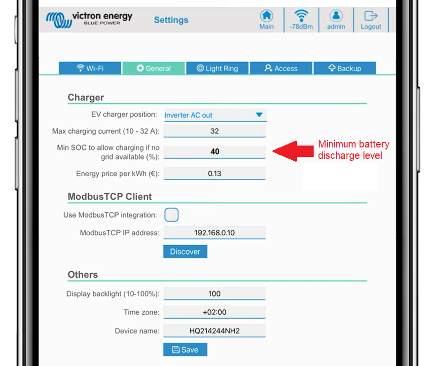

The smart ‘auto’ mode only works for grid-connected systems (with ESS), it does not work off-grid. (However, the Victron team is working on a firmware update to enhance the off-grid functions)
In ‘manual’ mode during the day, if the battery reaches the ‘Min SOC’ setting, the charger stops but will restart again as soon as the battery starts to recharge, but after a few seconds, it hits the min SOC again and cuts off. This on/off cycle can occur several times a minute and is not good for the equipment. (Again, the Victron team is working on a fix for this).

I spoke to Victron, and they said the auto-mode was not actually designed for off-grid use, but they are working on a new algorithm. Looking forward to seeing the improvements with the new firmware.
So after updating to the latest firmware version 1.24, Unfortunately, the issue with the charger cycling (turning on and off repeatedly), once it reaches the min SOC setting has not been fixed. This is very disappointing. It should be a simple software update to stop the charger from resuming charging until the battery SOC has increased by 1 or 2% above the cutoff level. During the day, when the system is charging, and the solar generation is less than the charge current, it can turn on and off every 10 to 15 seconds for hours on end which could potentially damage the charger or vehicle.
Another frustrating issue is that you cannot change the min SOC setting via a GX device; this can only be changed if you log into the charger via wifi. Most other settings can be quickly and easily changed in the attached GX device, and it’s baffling why they don’t also allow you to change this setting.
