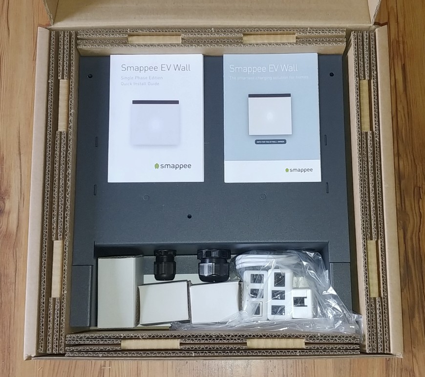

The first impression was that the EV wall charger is a solid, durable unit built using a sturdy steel housing and aluminium cover. The steel mounting bracket is also solid, and the charger features an integrated residual current device (6mA DC / 30mA AC), meaning it does not require an expensive external RCD safety switch. I installed the non-tethered charger and will use a 7m type 2 charging cable.
The biggest difference between Smappee and other EV chargers is that it comes with a full energy management system that consists of several components, a CT Hub, wall splitter (connection hub), Smappee connect Hub (for Ethernet and WiFi), and 3 CT clamps (for the mains, charger and solar). Additional CTs meters can be easily connected for measuring individual load circuits. All the components seem very well made, and it was relatively easy to install following the clear layout diagram supplied (a CT direction guide would be very useful though).

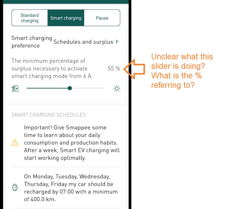

Also, I believe some settings have been lost in translation, and the terminology used is a little odd. I think the smart charging (schedule and surplus) setting is a good example. It is not clear what the slider is actually doing.

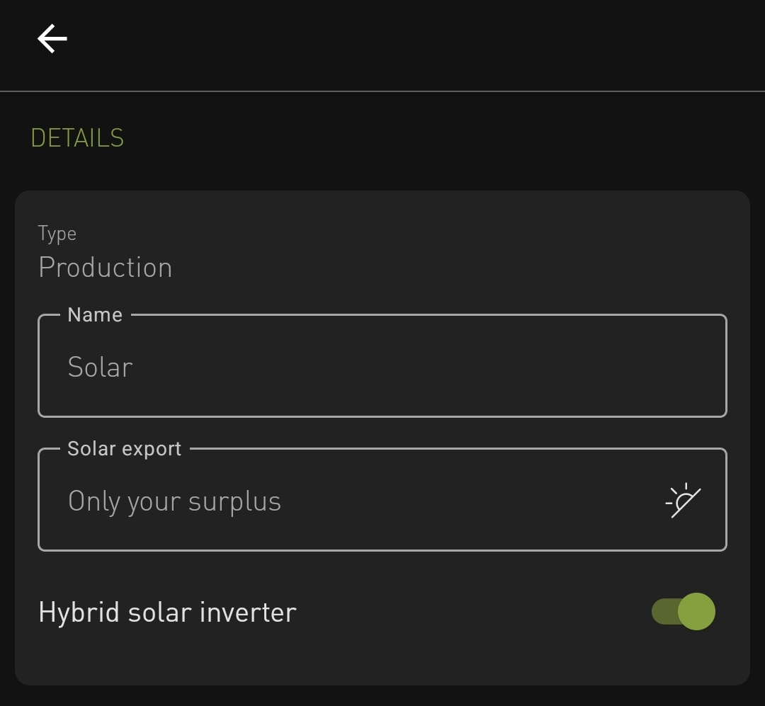

I have used the Smart charging (Surplus solar only) mode a few times, but it doesn’t quite work as expected. For some reason, it doesn’t quite match the export amount and is generally 500W less, resulting in 500W being exported to the grid, which could be used for charging. Fixed - This is due to the “hybrid inverter” setting being used - see more below.

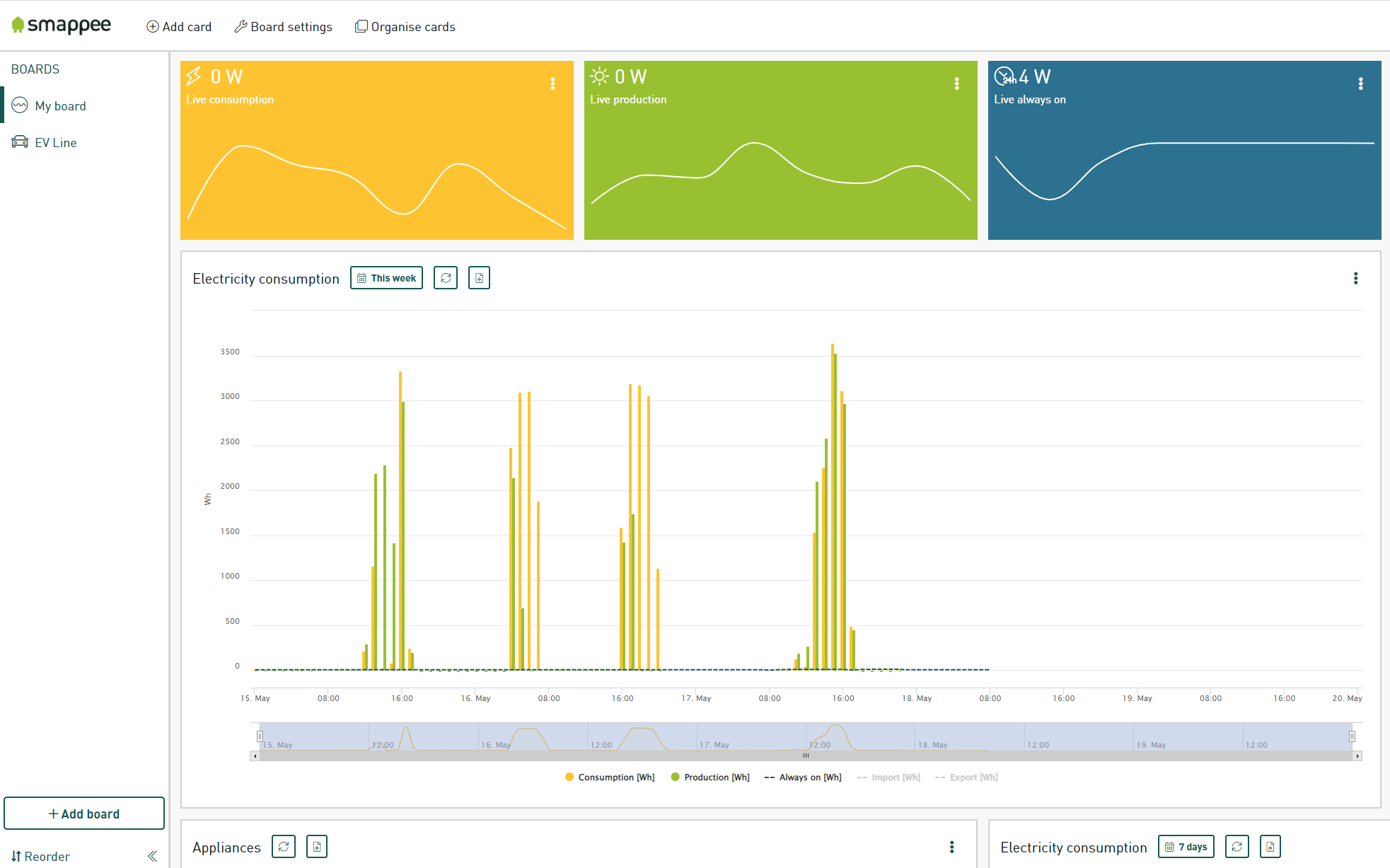

However, I like the desktop monitoring software (shown below), which gives a detailed insight into the charging history and allows you to change off the settings and operating mode easily.
Hi Svarky, the slider is allowing you to supplement some of the charging from the grid when your solar surplus is below the minimum to activate charging. All EVs have a minimum set point of 6A (roughly 1.4kW) per phase to start charging, as per the IEC 61851 standard. The slider allows you to supplement this minimum with grid power. E.g. 900W from solar and 500W from grid. Instead of exporting 900W for peanuts and not using this power to charge the EV

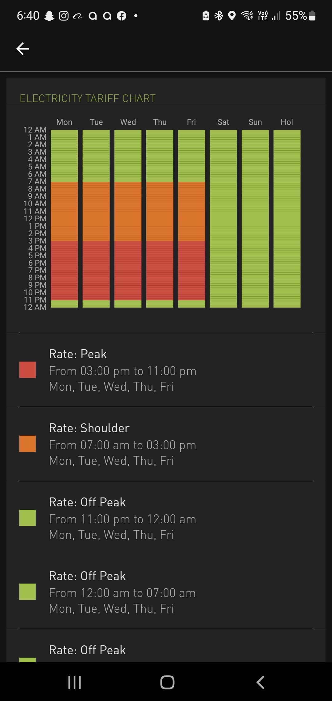

The idea with the smart charging schedules is to set your electricity rates and how much charge you need by a certain time (100km of charging by 7am for example). Once you have your tariffs and schedule set you can plug in and let the charger decide the cheapest way to charge by that time. In that case you would use schedules + surplus as the smart charging option. The charger will use solar when available, then top up with off-peak power over night.

This would be if you have hybrid inverter set for your solar inverter, it prevents you drawing power from the home battery by creating an export buffer. Your battery will only bring the grid import to 0w, it won’t export power. The Smappee will see the power drop below the export buffer and reduce the output for charging to ensure battery power isn’t used.

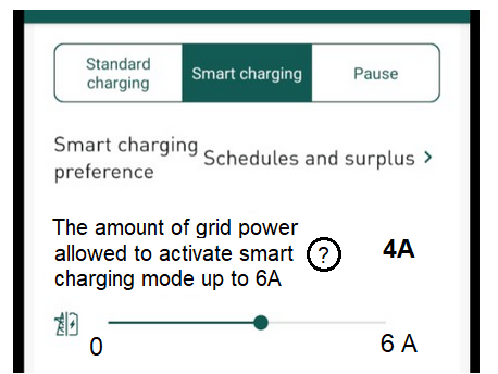

Thanks for the explanation. However, I still need to clarify exactly what the % is referring to. I’m gathering from your explanation the slider is a percentage of the 6A limit (1400W) allowed from the grid supply. For example, at the 50% level, up to 3A (700W) can be supplied from the grid to meet the minimum charging demand. Is this correct?
The problem is that we had to have this conversion to interpret what the slider is doing because the language used is rather ambiguous. In this situation, a simple fix would be to change the slider from percentage to Amps (A) or Watts (W) and remove the solar (sun) symbol on the right. Plus, a help “bubble” that offers more information about the setting. See mockup image below
I agree, it is somewhat unclear, especially if you’re not aware of the 6A minimum for charging per phase. I like the example you’ve presented. A pop-up option with a more detailed explanation would likely be helpful and probably necessary too. A short sentence just doesn’t really sum it up

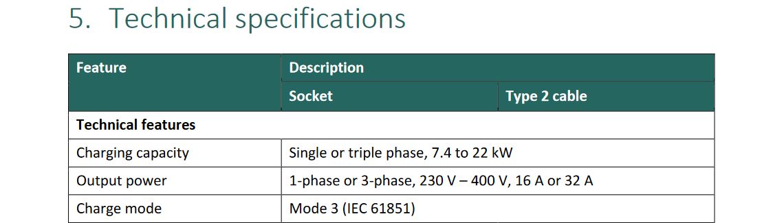

Oh, just read the spec sheet - the EV Wall is only 3.7 Kw on single phase - WTH? I just paid a few thousand dollars to have a 32A line dug through to our garage, I’m not sure only using 16A would make that worthwhile :frowning:
That can’t be right. The specifications show 7kW (32A) charging for a single-phase supply. I have charged at 7kW many times using the single-phase EV wall.
Where are you located? Are you using a 120V supply or something? I’m in Australia, and we have 230V supply.
The ones I’m looking at from Vista Power clearly says 3.7kW. I’m in Australia too.
“Options for single-phase ( 1 x 3.7kW) and three-phase (1 x 22kW) applications”
edit: the linked PDF for the EV Wall says:
“− Maximum charging capacity: Single or 3 phase, 3.7 to 22 kW
− Output power: Single or 3 phase, 230 V – 400 V, 16 A or 32 A”
Which is ambiguous…is it a range of values from 3.7kW to 22kW, or is it 3.7 for single phase and 22 for three phase?
