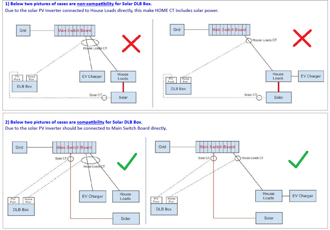

@Doris_Trevor & @ShaneS,The ZJ Beny Technical support just sent me an email explaining the CT installation using the Solar DLB Box. I wish they had included this information (instructions) with the Solar DLB box!
The CT positions is not the standard way to setup CT’s compared to other EV chargers and inverters!
Have you tried the set up zjBenny technicians have sent you . Does it work on Solar now ?
Thanks for forwarding to me .
@Doris_Trevor Yes, it works!
The CTs positioning is not the conventional way used by most other smart EV chargers. I wish they included the instructions and diagram with the Solar DLB box, it would have saved me a lot of frustration.
Thanks a lot , a big relief for me . Vaughn my electrician will be happy , he has spent a lot of time try to make ZjBenny work on Solar. Cheers Svarky

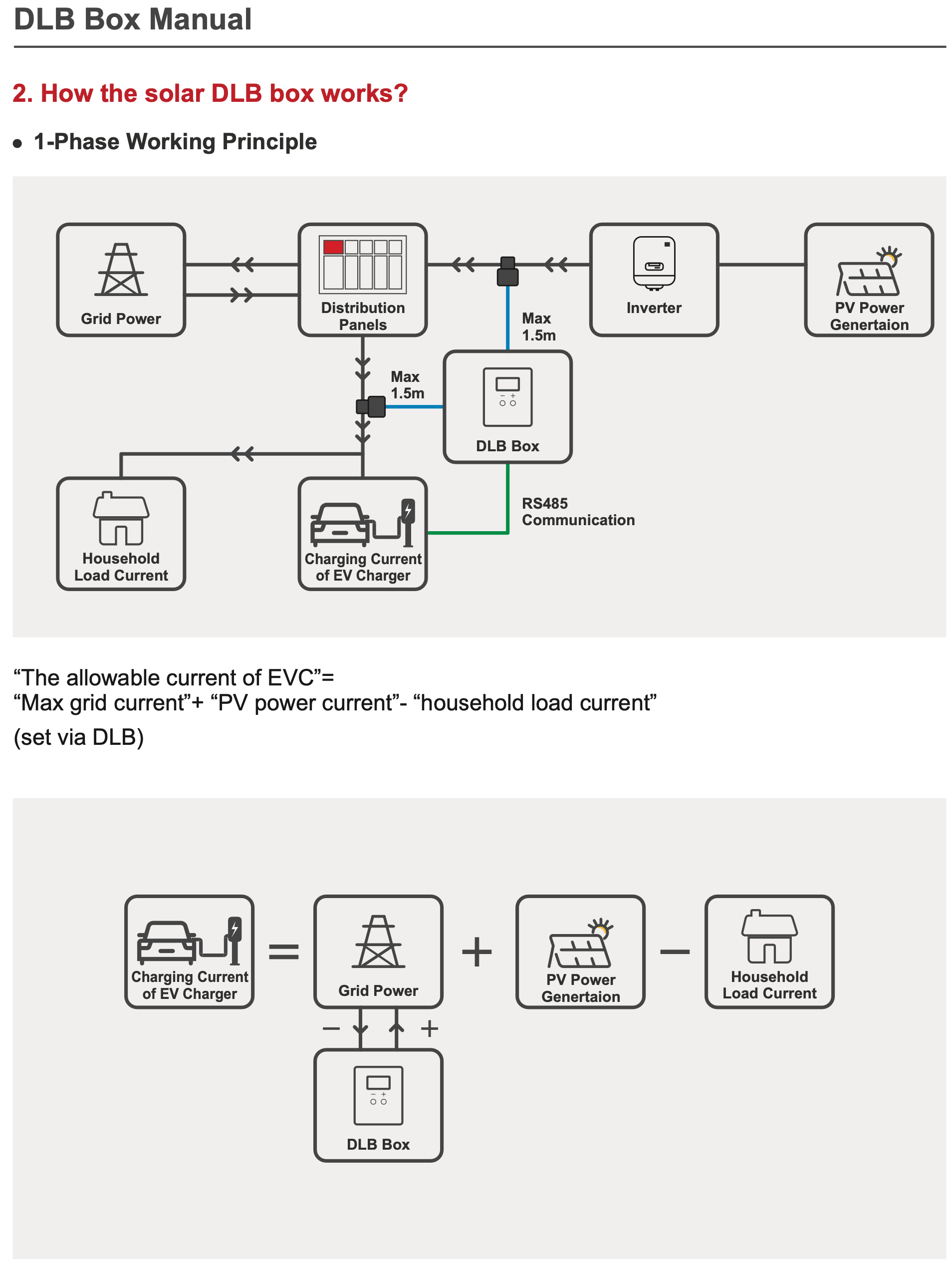

Right – that’s what I was saying above. I’m surprised you didn’t get the DLB Manual, which shows this arrangement:
@ShaneS, I didn’t get any manuals or documentation with the Solar DLB! So frustrating.

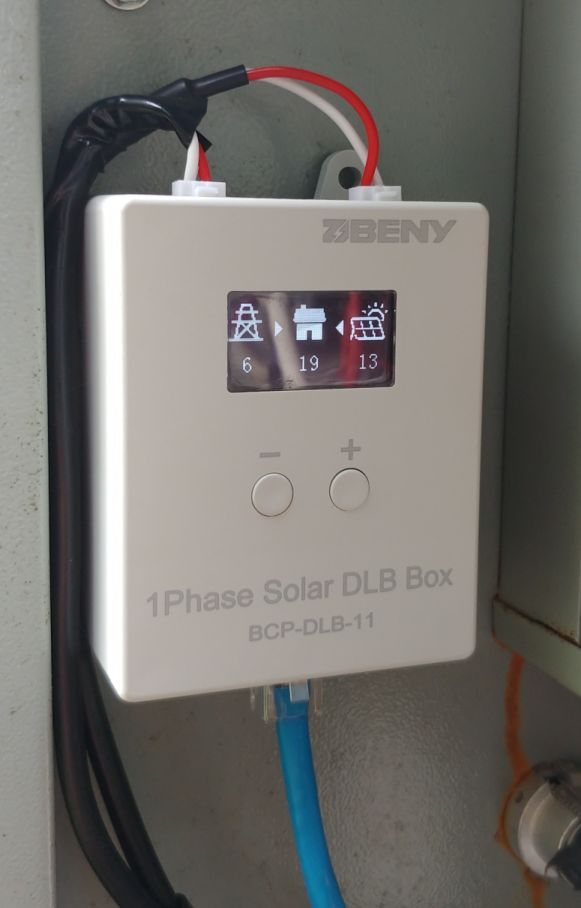

Did you accidentally get the 3-phase version? Do you have any photos or details?
