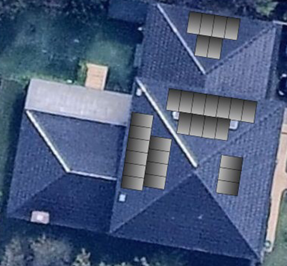

Just trying to decide on a few quotes so far. I am planning not selling so quality and minimal issues is a big focus along with high WAF.
Melbourne based. Some small amounts of intermittent shading. Also want to know output of each panel so will probably need to change the Fronius inverter on the last quote.
