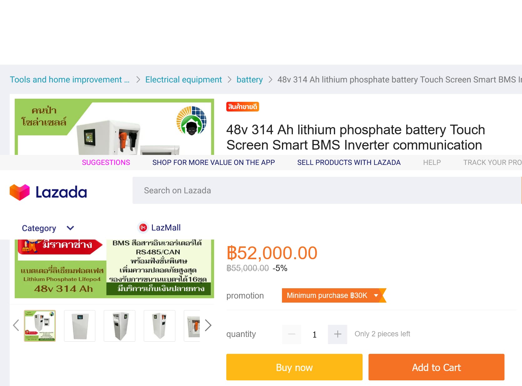

The first 2 batteries i got off a local solar installer for 75000 THB.. but the third one i got from Lazada for 52000 THB. (1600 USD).
