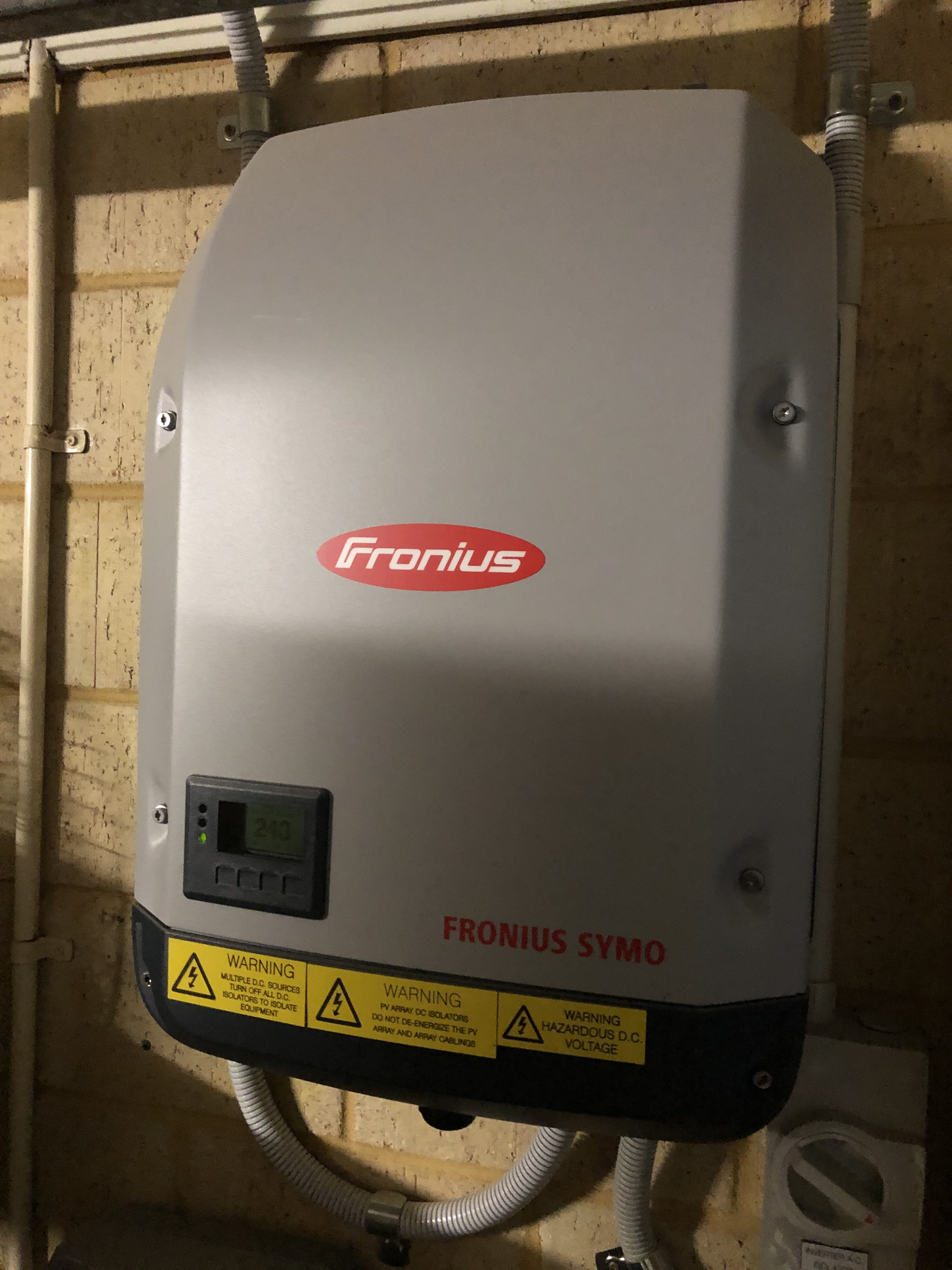

I installed my system on Nov 2019.
So far, I am pretty happy with my system and would strongly recommend the company Solar2020 whom installed my system.
  • My system is a 6.66 kw
  • Panels are LG Neon R - 370 w per panel that comes with 25 yrs product and performance warranty. So I have 18 panels on my roof. I split half the panels on my North facing roof and the other half on my West facing roof.
  • Inverter installed is a Fronius Symo 5 kw unit Think it comes with a 5 yrs warranty
  • Total system cost $12,990.00 ($2 per watt)
  • STC rebate $4015.00
