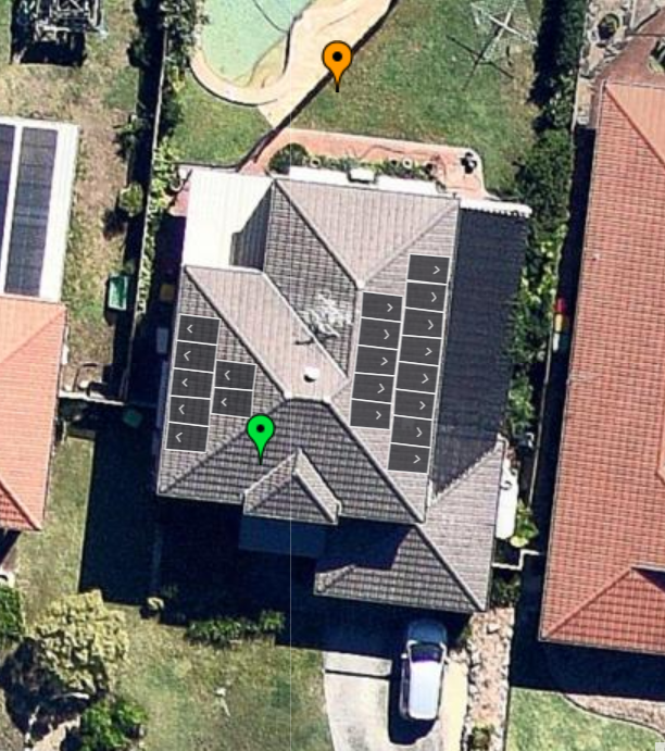

Here’s a view of my roof:

First of all, I’m curious as to why you wouldn’t use your north roof? That’s where you will get the most sun.

My North roof is tiny - it’s that triangle in my picture between the 2 sets of panels.
