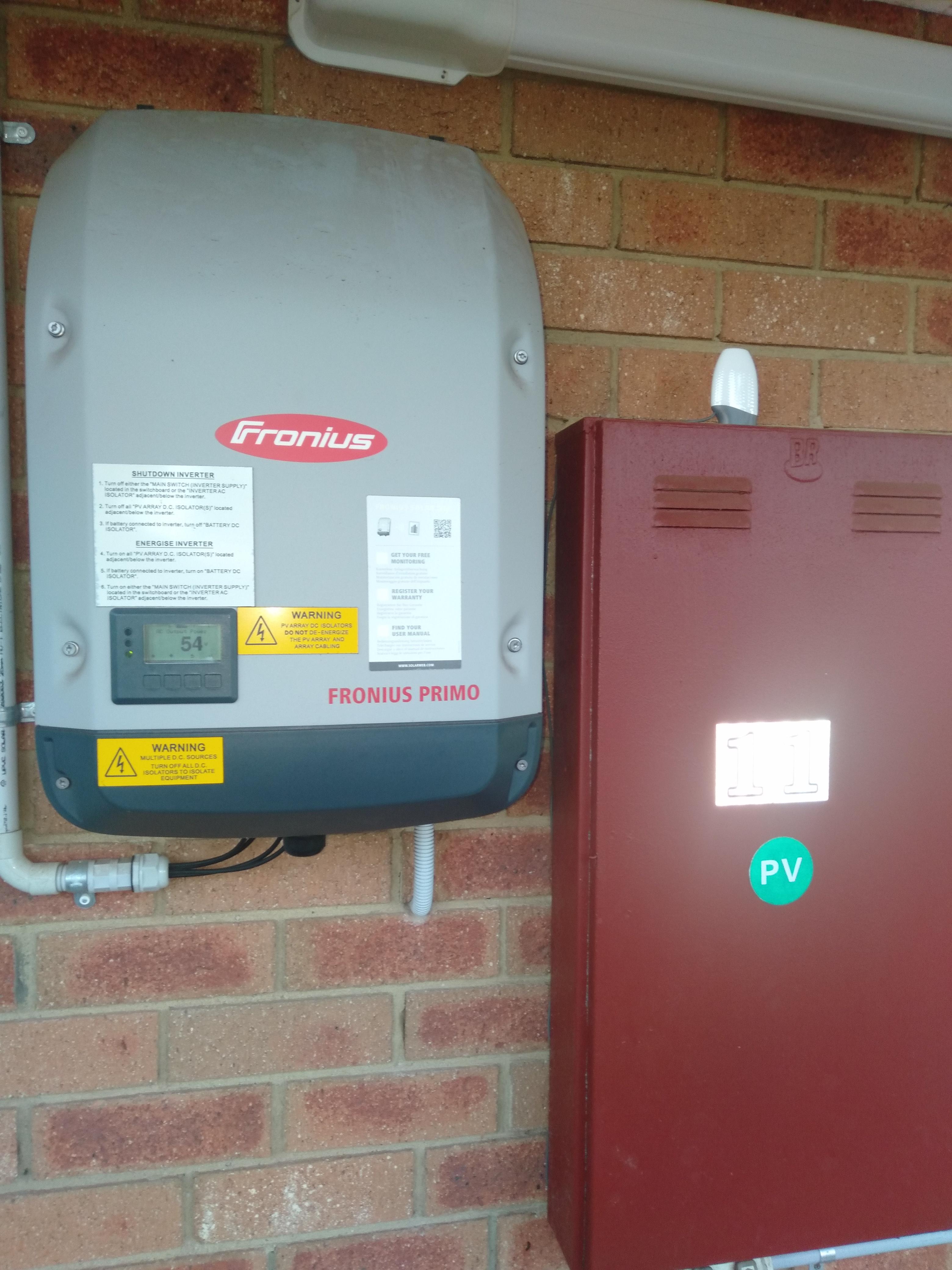

UPDATE MAY 2020
When did you get your solar installed? Jan 2019
What Panels and Inverters did you get? Jinko 300watts & Fronius 5.01
What is the size of your system? 6 kWatts
What Solar Company did you go with? Would you recommend them? Green engineering solar. Yes however they have a dedicated team for every service so you’ll not speak to the same person every time.
What is your estimated payback period of the system? 10 years
Are you happy with your solar system? Yes very happy I’m in credit every bill(quarterly)
Would you do anything different next time? No the inverter can only covert a max of 5 kw capped for residential so even if I wanted to put more panels it wouldn’t serve any advantage. So I’m happy with 20 panels

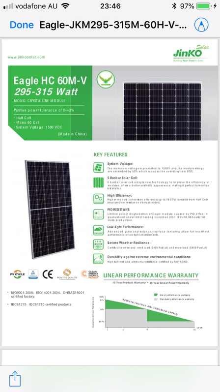

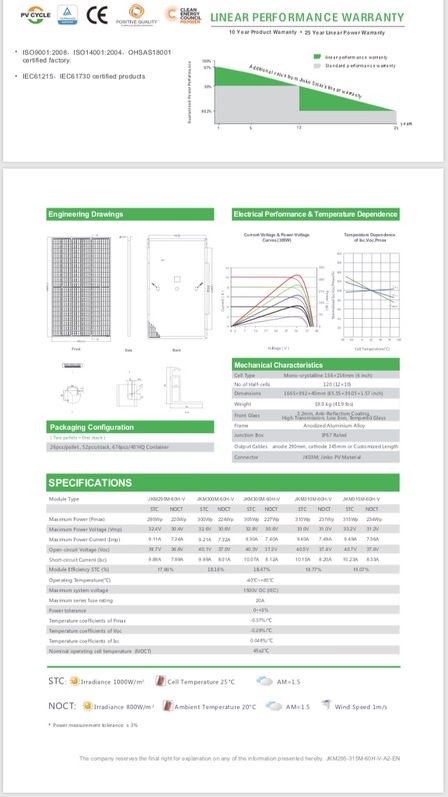

Hi BHeckman thks for getting back. The 60M 285watts was quoted by Grenlink Solar.
The AC60 300watts was inirially quoted by Green Engineering but later yesterday they sent me another brochure of Eqgle HC 60-V.
Im attaching both of their datasheets. They r not very clear pics.

The HC60M-V 300watts panels will be connected to a fronius primo 5.01. And im installing the panels both north & west side as that will give me optimal generation throughout the day.
So if i was to compare
Eagle60M 285Watts x18 Panels(JKM285M-60) with FroniusPrimo 5.01Aus at $5800 net
Vs
EagleHC60M-V 300Watts x22Panels(JKM300M-60H-V) with Fronuis Primo 5.01 at $5100 net
besides the price which is the better of the two quotes.(keeping all other factors constant i.e split array north & west & inverter in shaded area)
Also a quick question from the datasheet:
Fronius Primo 5.0-1-AUS has an AC nominal output of 4600watts
Fronius Primo 5.0-1 has an AC nominal output of 500watts
Does this mean the 5.0-1 has a better/more conversion ability to the 5.0-1-AUS as im putting 6600watts or 5130watts of panels
Hi Aal,
Unless I’m missing something, the 22 x 300W Eagle HC panels are a significantly better deal.
My understanding, though I could be wrong, is that a bunch of 5kW inverters are restricted to 4.6kW output by software for the Australian market, because of limits in some jurisdictions (the whole of eastern Vic for example). If this is not a concern in your area, then you’ll certainly be better off with a 5kW output given panels you are looking at.
