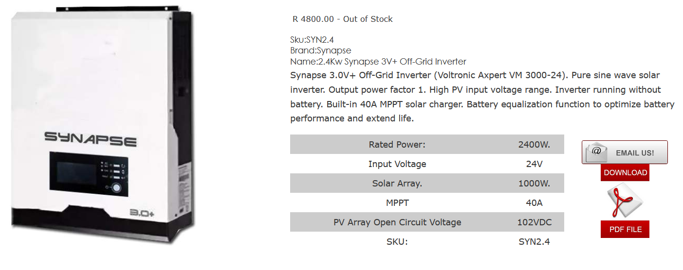

Hi Svarky, thank you for the answer. I made a mistake it is 24V not 12V.The inverter is Synapse 3V+.
I don’t know the exact type of MPPT, but the specs say max 1000Watt.
Would I damage the MPPT if I connect 1365 watt panels? That would be 3 x 455Watt in paralell.
In winter that woul sometimes give less than 1000watt but in summer it would be more.
I just look it up and the Synapse inverter is actually just a rebranded Voltronic inverter. They do not have a very good reputation so I would not recommend going over the specified limit.
It’s probably safer just to buy a separate MPPT that can handle the extra solar. For example, the EPever AN series MPPT can be oversized by 150%.
