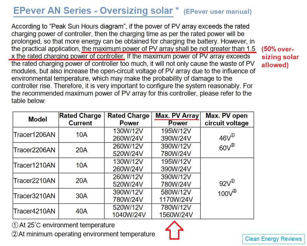

@Alloy yes, some higher quality MPPT solar charge controllers such as those from Victron Energy let you oversize the solar and put up to 750W on a 20A unit. Just be careful not to go over the INPUT current limit of the charge controller.
The Victron 100/20 is able to handle more than the nominal rating listed on the spec sheet.

Thanks for your reply. I suggested the Epever (TRACER-AN-SMS-EL-V1.0) 20A/24V MPPT controller for the client but wanted to be sure I am doing the right thing.

Hello I have EPEVER tracer 30amp for dc load and 12v battery pv 390/12 780/24v but I installed 300*2 in parallel. So 600 watt . Pv wattage oversized but pv volt and amp in limits pv volt 40v amp 28. But worry it may damage my controller
@Wisal_Ahmad yes, that is a little higher than the manufacturer’s specifications so it may reduce the life of the controller. However, if you live in a cooler climate I wouldn’t be too concerned about the extra 20W. If your system is installed in a hot location with high temperatures I would be much more careful as it might damage the controller.

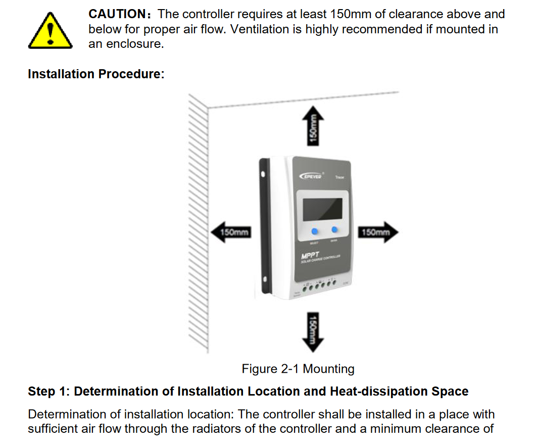

Also, remember to allow adequate clearance for cooling. At least 150mm

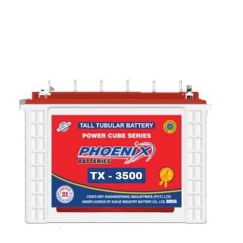

still more than 390watt for 12v but less then 580watt . Please I need opinion about this battery it’s tall tubular battery 280a will my 30amp controller will charge this battery
Yes I may install 12v computer cpu Fan for cooling under controller. I check temperature in solar station software it’s 33c and environmental is 18c. I want to buy 40amp but expensive in Pakistan

Fine but the battery is tall tubular with 9 plates and it’s deep cycle flooded battery mostly used in 24v or 48v solar projects, most battery dealers told me that it’s not the job of your controller to charge this hard battery so I am confused. I have 12v dc 28 lights and 7 ceiling fans and water pump. in Pakistan there is shortfall issues energy crisis so dc is the best solution
Is it a 12 volt battery? If it’s 12V, then no problem.
Do you have battery specifications or datasheet?
No I don’t know but I will try to get from battery shop and will share
