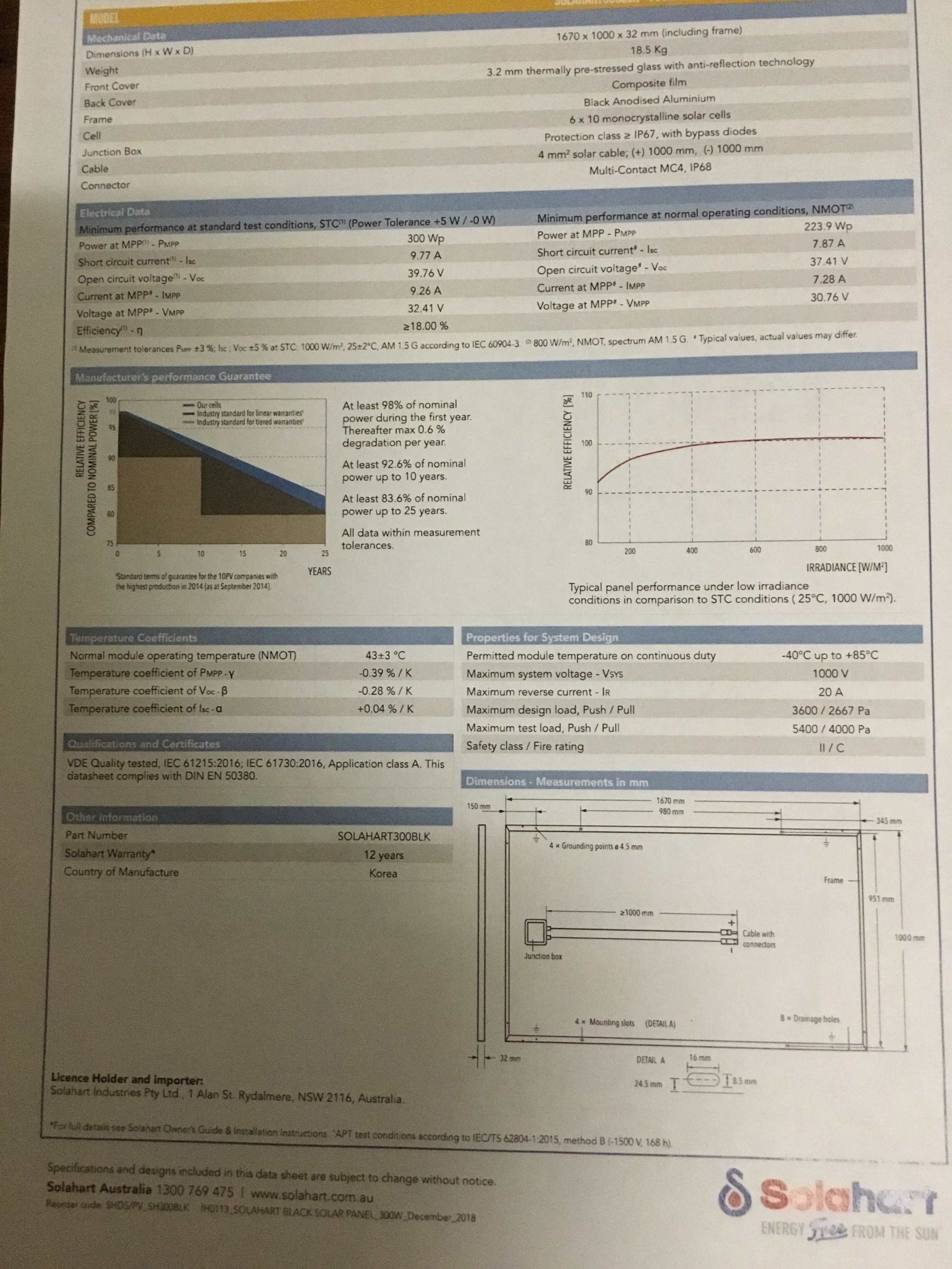

I have received a quote from Solahart. They have pushed fairly strongly for their own brand panels and inverter. Solahart Black 300W solar panels and Solahart ABB single phase inverter. The quote is $7495. I have the option to use different panels and inverter if I so choose. I have read some dodgy reviews about ABB and I am leaning towards a Fronius Primo inverter, which would be the same price. I think the panels seem okay. What are your thoughts on this deal? Is it a fair price? Are the Solahart products reliable? Any advice would be appreciated.

As for the panels I would ask them who manufacturers the panels for Solarhart and what are the warranty conditions? If you have a specification sheet for the panels feel free to post it up and we can see the details.

Specs look similar to some of the well known manufacturers such as Q cells. 12 year product warranty is good and degradation rates are also good. I’m guessing these are rebranded Q cells panels which is a good sign.

Why would you rebrand a good brand like QCells, seems strange. Probably worth confirming with Solahart as to who the actual manufacturer is @hbmeri.
I met with Solahart yesterday and he told me that the panel are Q cells. I’m interested to hear your discussion as I’ve been reading that Fronius seem to be consistently a preferred brand too.
