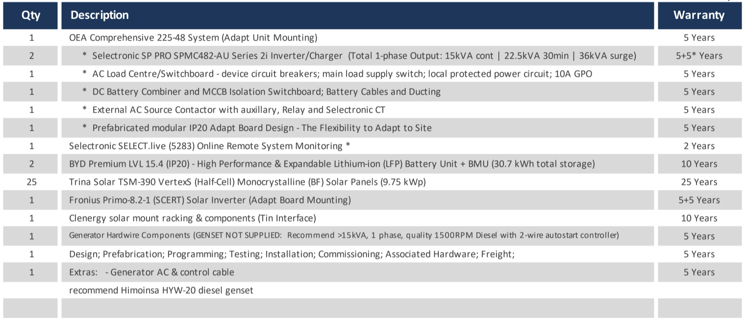

What solar inverter did they specify, Fronius 8.2kW?

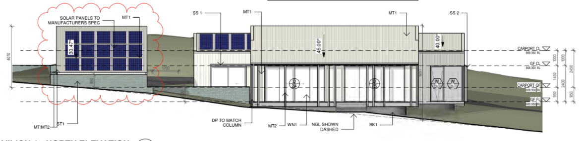

Also, as @Marty highlighted, the solar array seems undersized in comparison. Is the solar array North facing with a decent tilt angle?

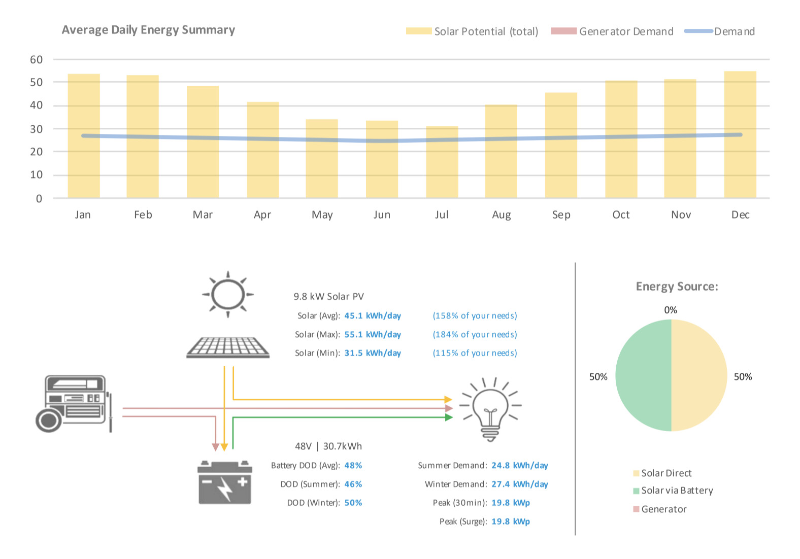

Hi!
Yeah we have done an assessment of the usage (based on the new house though, as we currently live in a tiny place without a dishwasher/induction stove/etc):
I think the 15kW inverter is because of the peak loads and we will have a backup generator (we need to source that separately though so it’s not include in the price, any tips on which one to get would be great!).
For the solar inverter it is the Fronius, here are screenies of the breakdown for both options:
And the solar array will be north facing and on a pitched roof:
Thanks so much for the questions and thoughts!
Tom.
Ok, I see they are using 2 x SP PRO 48V battery inverters, not the larger 15kW 120V SP PRO. This makes more sense now.
