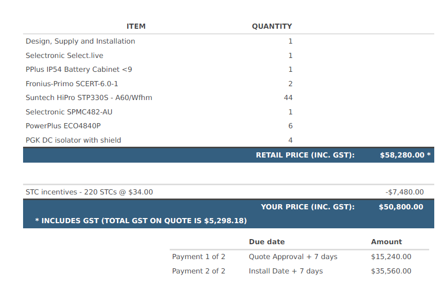

Two quotes, both use Selectronic/Fronius, off grid system. Both the same size and minimal difference in price. Which product combination is better?

Both are good options. I personally prefer Powerplus batteries due to local support and manufacturing. REC are slightly better than Suntech panels though. I think it might come down to which installer you trust the most.

Would you still choose the PowerPlus over the GenZ considering the PowerPlus are the eco model not the premium? The Eco SOH is 60% and the GenZ being 80% at 10years for warranty.
Yes, I’ve been using the ECO batteries on my own off-grid home and some other installations. I’m very impressed with the performance so far. I’m probably biased though as I know several people who work at Powerplus and have had extremely good service and inside knowledge of their engineering capabilities.
If you think you will be regularly deep cycling the batteries (down to 20% SOC) then it might be worth going for the GenZ over the ECO. However this would indicate your battery bank is undersized.
