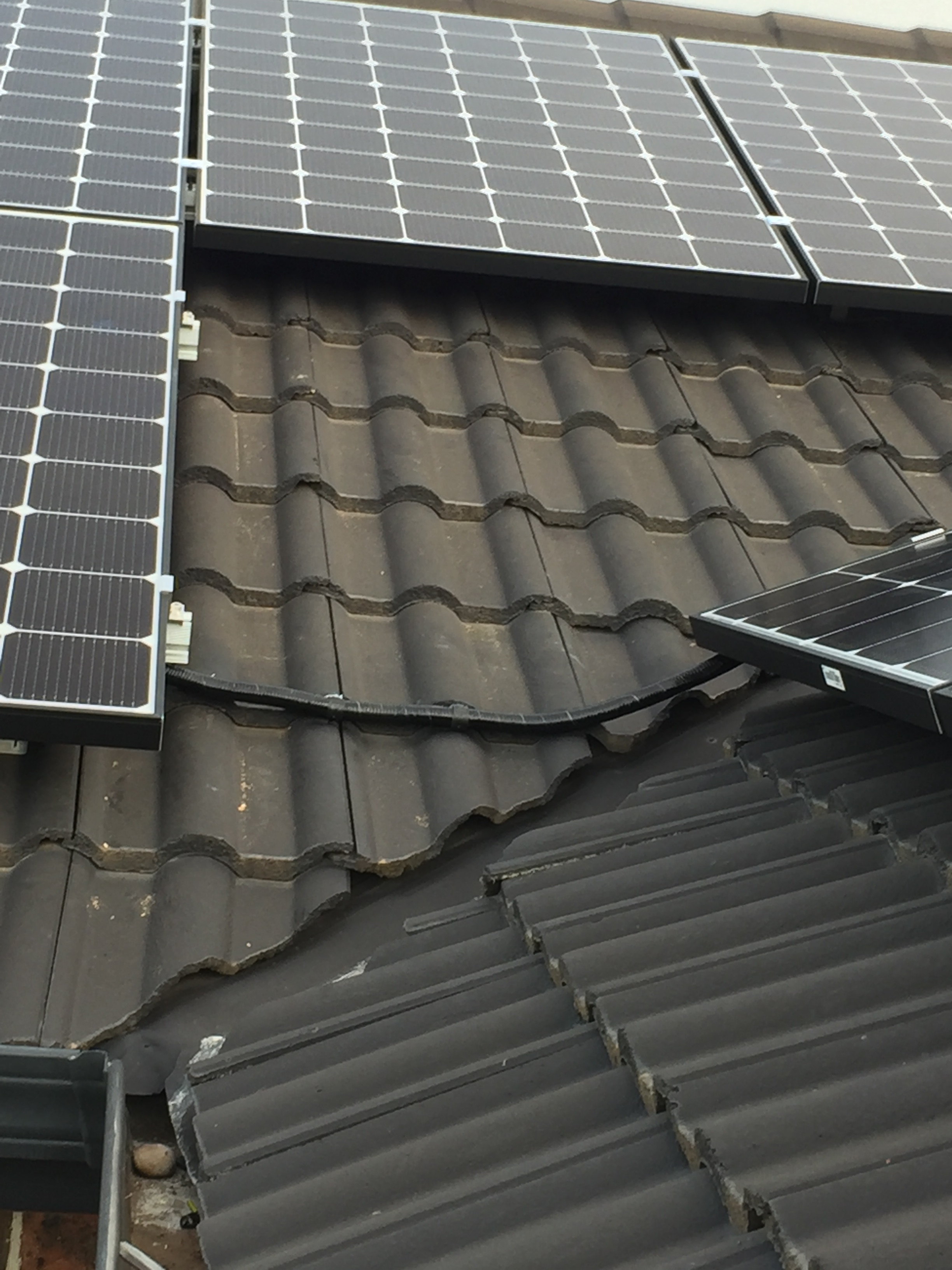

I have a question with the installation for the array, the installer team told me that they would run the cable to connect the array group together under the panel, and they did, but I just notice that it’s very visible and exposed to the sun about 1 meter, is this safe? will they last for long? will it be an issue in the future? see the picture.

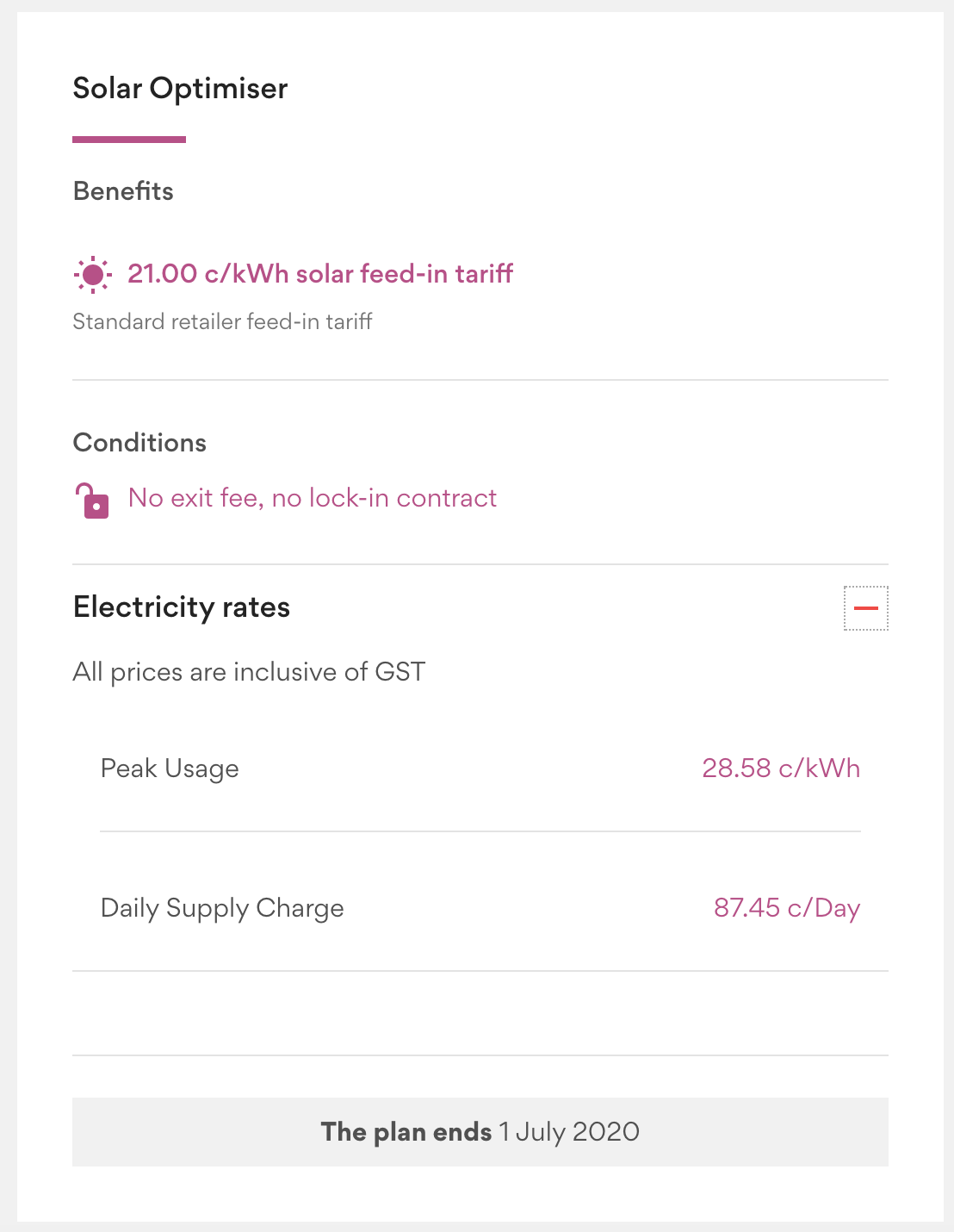

hi @Adel_A, yes, I am getting that solar optimiser plan from origin when it is up and running.

Hi helmen,
That looks like UV rated heavy-duty solar conduit but it’s hard to tell. It’s very lazy to do it this way and no secure it properly to the roof or run it through the roof cavity.
If it is the solar UV rated conduit it will last for a long time, however should be supported properly by additional rail or attachments.
Hi everyone,
Thanks for the reply, the installer fix the exposed conduit and make it look lot nicer by running it under the roof.

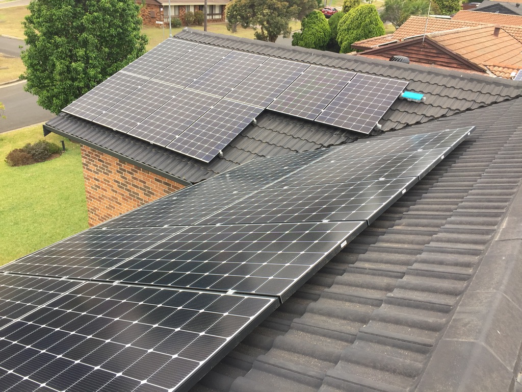

and yes, really happy with the 7kW system, it’s producing 49.2kWh yesterday with sunny day, it only clip for an hour in during midday 12PM to 5.9kW (the max of 20x 295W MI), and during the weekend, the system still producing around 20kWh with very cloudy day and almost no direct sun at all. not sure if it can reach the 50kWh mark or not in the midsummer :smiley:
I’m still waiting for the meter provider from enabling the solar feed-in.
Thank you for all your help everyone!!!
