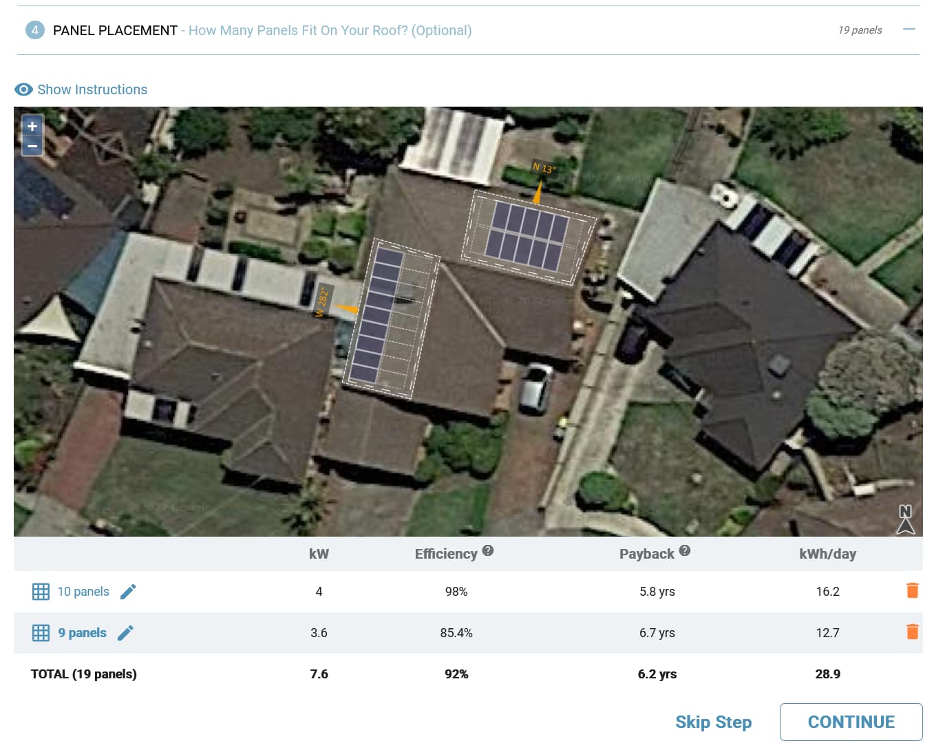

The updated solar calculator tool from Clean Energy Reviews shows exactly much solar can reduce your electricity bill. It also has a battery and EV charging calculator included.
The best part is that you can actually place panels on your roof (if the map is available) so you can see exactly how much solar power will be generated and work out the best location and orientation for installing panels on your roof.
