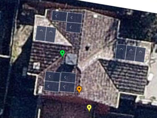

Yes i do have a limited roof area… can only fit 12-13 max facing n, w, & E… Possibly just n & w.
www.dosolar.com.au Thats the company
How many panels can fit on each roof face? 12-13 across all roof sections or just North?
split between the 3 faces.

I can’t believe these companies quoted a normal string inverter with your roof. Only 5 north facing panels will not have enough voltage to even start the inverter!
You really need to go with micro-inverters with this roof layout. Enphase micro’s are really the only option for your roof, especially considering the shading from the rooftop evaporative cooler.
