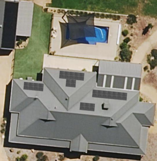

Not sure if the photos worked. Is this a good arrangement for the panels on the roof?

Firstly, that layout does look like the best from that image. Nice to have a big north facing roof like that.

I will go for the ENPHASE Micro Inverter Sys because of so many Split Array , you will get alot of mismatch of energy every moment. and Enphase sys is easy n simple to understand, and save you alot of money when come to the trouble shoot if happens, I see that you have 21 panels max. I do not understand the Govt Loan are you in Victoria ? about the panels you must go for higher wattage panels at the moment 350Watts already available even 380W if installer do not mind the 2 m lenght
