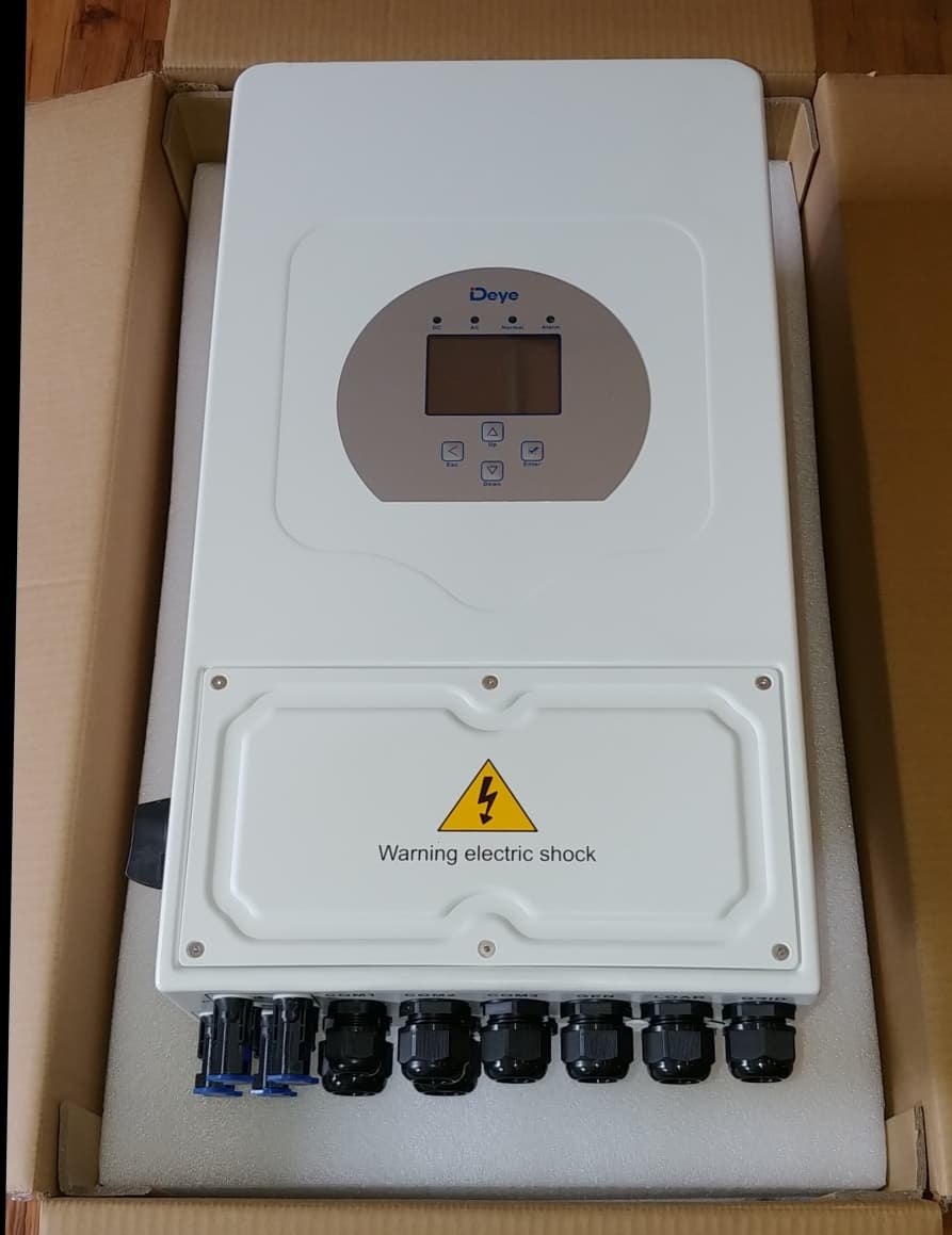

Deye hybrid inverters have become increasingly popular over the last few years, so I decided to purchase one of the SUN-8K hybrid inverters to see how they perform for off-grid use. For reasons explained below, I’m generally not a fan of all-in-one inverters for off-grid systems. However, if the specifications are accurate, this could be one of the first affordable all-in-one inverters suitable for smaller-scale off-grid installations. Update: The Deye inverter has recently been included as one of the best off-grid inverters for small capacity systems.
** See the new, updated 2026 Deye Inverter Review here: Deye Inverter Review - 2026 update
Deye Vs Sunsynk Vs Sol-Ark Vs Noark
Several companies worldwide have rebranded and modified Deye inverters to suit local markets. However, they are all manufactured by Ningbo Deye Inverter Technology Co. SunSynk inverters are very popular in the UK and South Africa and are identical in hardware but use different operating software. In North America, Sol-Ark is the primary distributor and has modified Deye hybrid inverters to suit the US’s split-phase (120/240V) power requirements.
Update: In Australia, the popular electrical components supplier Noark Electric just released a Noark-branded version of this inverter as well.
SUN-8K Inverter Power Rating :zap:
Deye inverters are transformerless, unlike dedicated off-grid inverters, so they do not have the peak (surge) power of similar-sized off-grid inverters like Victron or Schneider, which use large, heavy-duty transformers. The specifications are confusing as the datasheet does not list the continuous power rating but multiple variations of the peak (Max) power rating. :thinking:
The max battery discharge power is listed at 190A, or approx 9.5kW at 50V, but the off-grid peak power is listed at “2 times the rated power for 10 seconds”. This peak rating would only be possible with battery and PV power combined. The “rated AC output power” is 8kW, and the “Max AC output” is also 8kW, which doesn’t make sense. I’m assuming the continuous power rating is closer to 7kW, and the max peak power is around 10kW, but I’m yet to test this in real-world conditions.
High Solar MPPT current ratings
In regards to solar, the MPPT voltage range is a bit narrow (200V to 425V), but the input current rating is very good at 26A per MPPT, meaning parallel strings is possible on both MPPTs. :+1: Ics max current is also very high at 39A per MPPT, which is great. The max DC input power is listed at (10400W) 10.4kW, but based on the high input current rating, it should have no issues with oversized PV arrays higher than 10kW.
Build Quality
The build quality appears surprisingly good for a relatively low-cost inverter. The dual AC inputs are very useful for UPS backup power in a hybrid system. The on/off and DC isolator switches are solid, and the large cable glands make it easy to install. Battery terminals are solid, but a little more clearance would help.

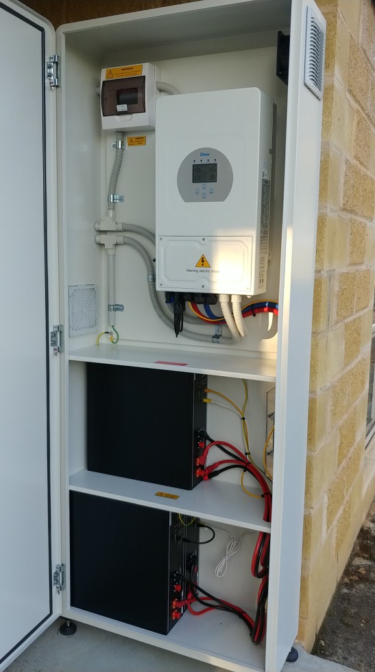

Update: The inverter was installed and commissioned about a week ago and is running great so far. Installed with 6.2kW of solar on two strings, and 3 x Pylontech US3000C (3.55kWh) batteries.
Startup and programming were relatively straightforward. However, the Lithium settings are a little confusing, and the manual has very little information about how the system should be configured for various lithium battery types (see more details below).
The household loads are generally very low, so we haven’t had a chance to test the inverter under higher loads to see what the continuous and maximum power output is. (The house is still under construction, and some electric appliances are still yet to be installed.)

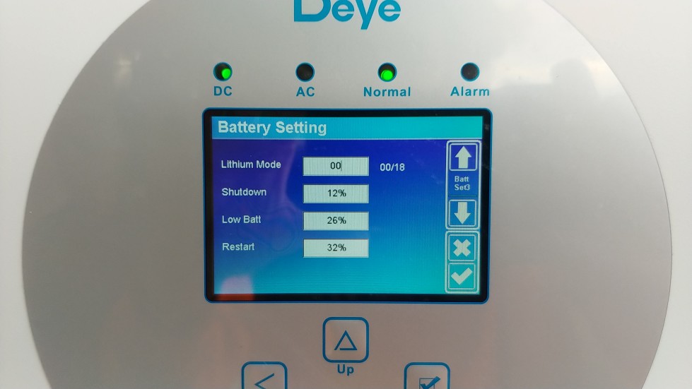

Lithium Battery settings: One of the more confusing settings is the “Lithium Mode” setting which I cannot seem to change? It is set to 00, but there appear to be 18 settings from the display. (Or that’s what I assume the 00/18 is referring to?)
Also, as mentioned previously, the battery data is very limited. The battery temperature reading was -100C as soon as it was connected, which is clearly wrong.
EDIT: This issue has been fixed by using the correct CANbus cable with pins 1,2,3 disconnected, as shown in the post below.

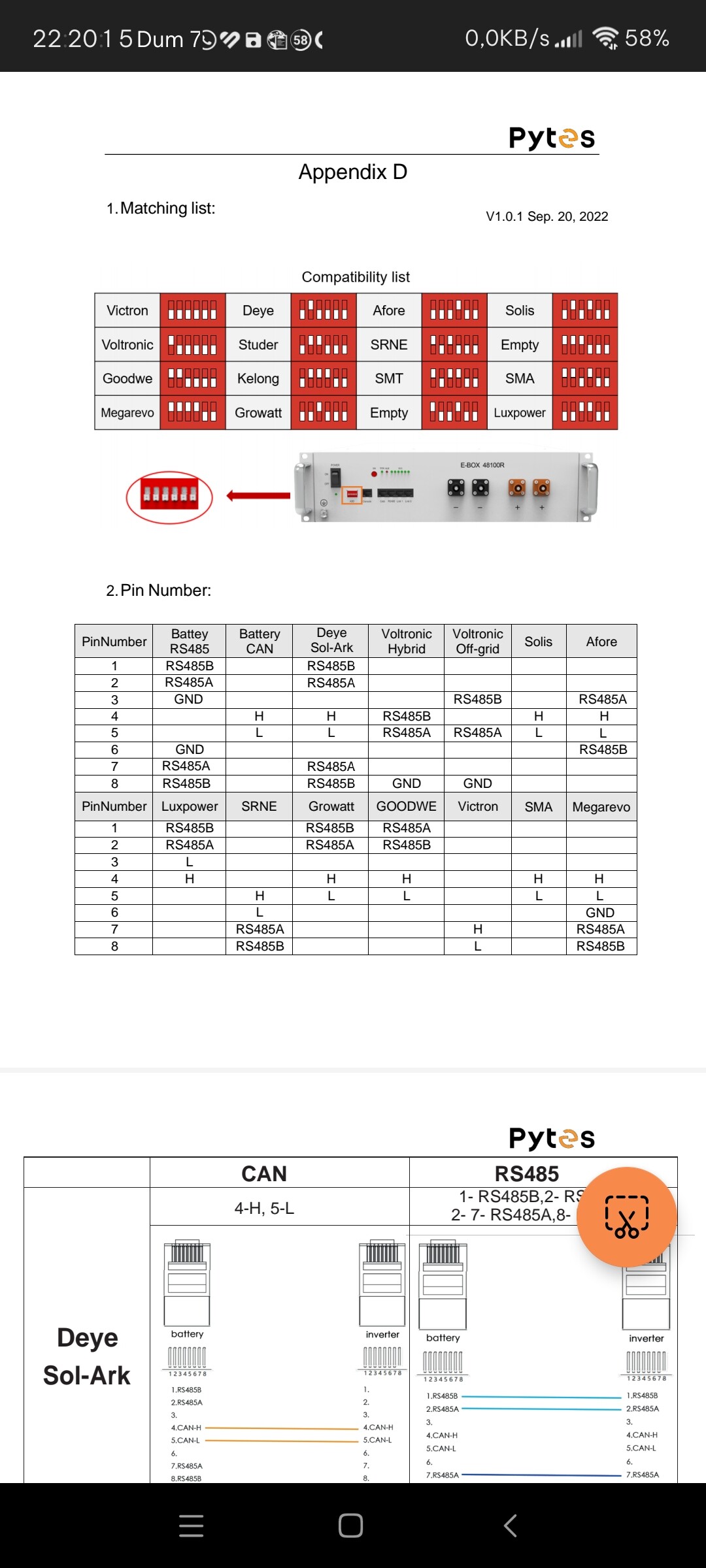

Regarding the batteries. Between your Deye manuals and literature you have a document regarding Lithium Mode settings. It’s a list with most LiFePo4 battery brands and what lithium mode to use with each brand and battery model. Also with your LiFePo4 battery you again have a list regarding the settings of those small red and white dip switches. On the battery documentation you have a list of inverters and how to set those dip switches for communicating properly with each brand of inverters.
You need to have both documents in order for the inverter to comunicate with, and charge properly the batteries, similar with my examples.
@Bursu, thanks for the Lithium mode settings (approved battery) document. This should be included with the inverter as there is no information provided about the various Lithium modes.
The Pylontech battery is listed under lithium mode ‘00’ Canbus, and also lithium mode ‘12’ RS485. This is strange, but I’m guessing it will work on either mode. Although, when I tried to change the mode from ‘00’ to ‘12’ setting, it would not change. It was stuck on ‘00’ which is very frustrating.
The inverter can communicate with the battery’s BMS in two ways. Primarily, through the BMS/CAN combo port, which is recommended, I had to use a splitter to combine two cables into the BMS port (Orange Pi 3 LTS and Battery) or, alternatively, through the RS485 port.
The whole document that came with my inverter DEYE - SUN-12K-SG04LP3. It has 19 Lithium Modes in it’s battery menu.

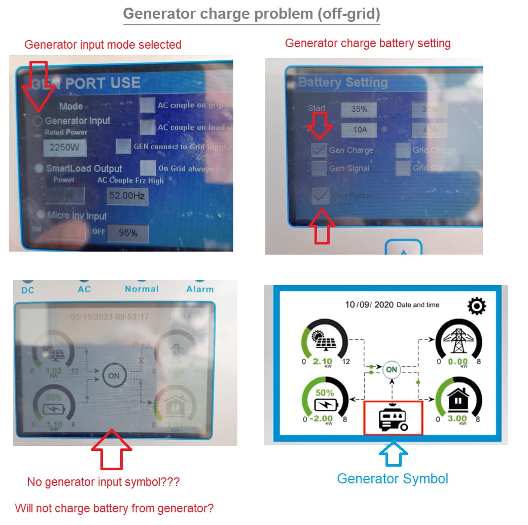

Problem charging from a backup generator. I have followed the setup procedure and changed the settings to charge from a generator, but it does not work. The Generator symbol does not show on the display, and it will not charge from the generator when connected. (It is a manual start generator, not auto-start)
Edit: Problem solved - See post below
Hi, I do not have a generator but as I understand, if you have batteries, as in my case, the inverter will seek for generator signal, and display the generator icon, only when the battery is near a certain percentage that it set for the battery to disconnect the power and no Grid is available, OR in order to start charging the batteries using the generator. If you are not using batteries, that Icon will appear when the grid fails and when there is not enough energy being generated by the panels, at night for example.
Basically the icon appears when the Inverter tries to use the generator, in emergency situations. At least this is how it behaves when using have batteries too.
Maybe if you also check GEN signal option, on the display, generator icon might show up.
I am new to this too, i hope it helps a little.
Best wishes, Marius
Backup Generator charging issue fixed

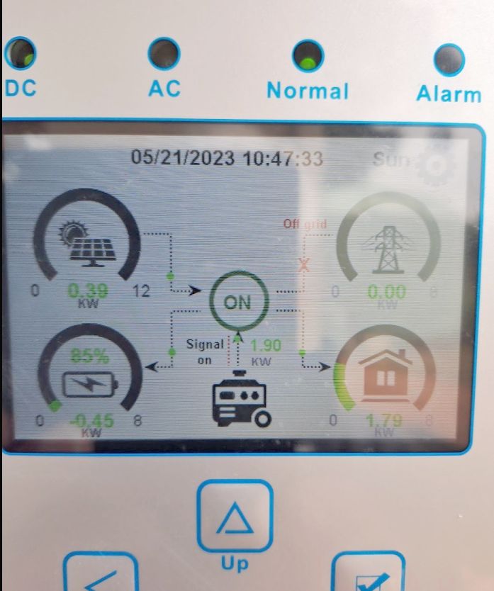

The system is now charging from the generator input. :+1: The problem appears to be due to the unstable generator frequency, which is a very common issue with older generators. Also, as suggested by @Bursu, the Gen signal checkbox setting should be ticked (Even though the generator is not an auto-start model). The generator icon only appeared once it was connected.
