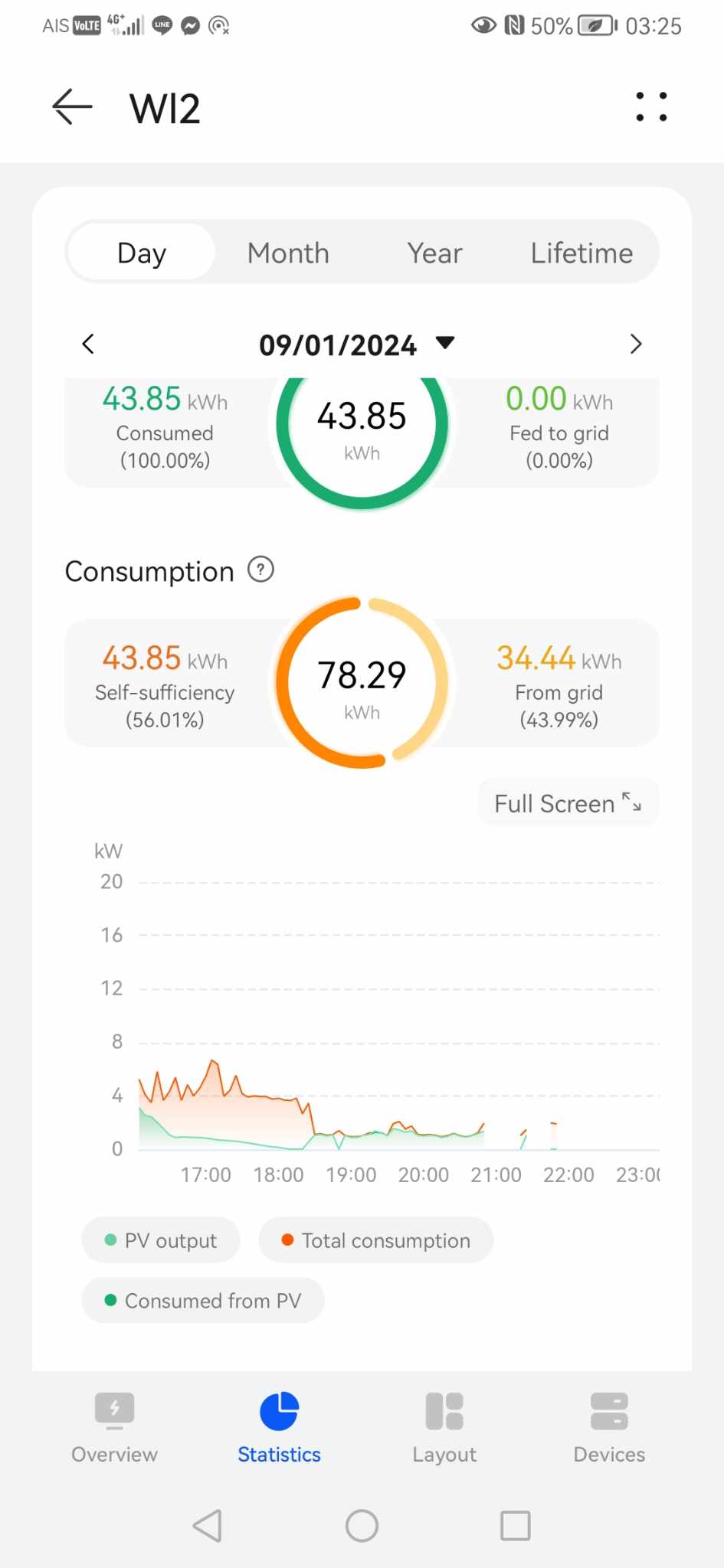

Today I connected the Converter to the Solar inverter string input to test if it works. (used power from the normal plug instead of the car).
It actually did work. The Inverter sowed 1.9kw solar power (at night).
But there was a problem with the converter starting to turn on and off frequently. Increasing the power used by the house seems to have fixed it, but it would kind of go against the whole point of the experiment if I have to increase Power usage in order for it to work.
Any Idea what might cause that issue? The converter makes a beep sound about every 7 seconds, power output goes to 0 amps, then beeps again, power goes up again then repeats the hole thing. When I increase the usage, it still beeps, but power does not go off.

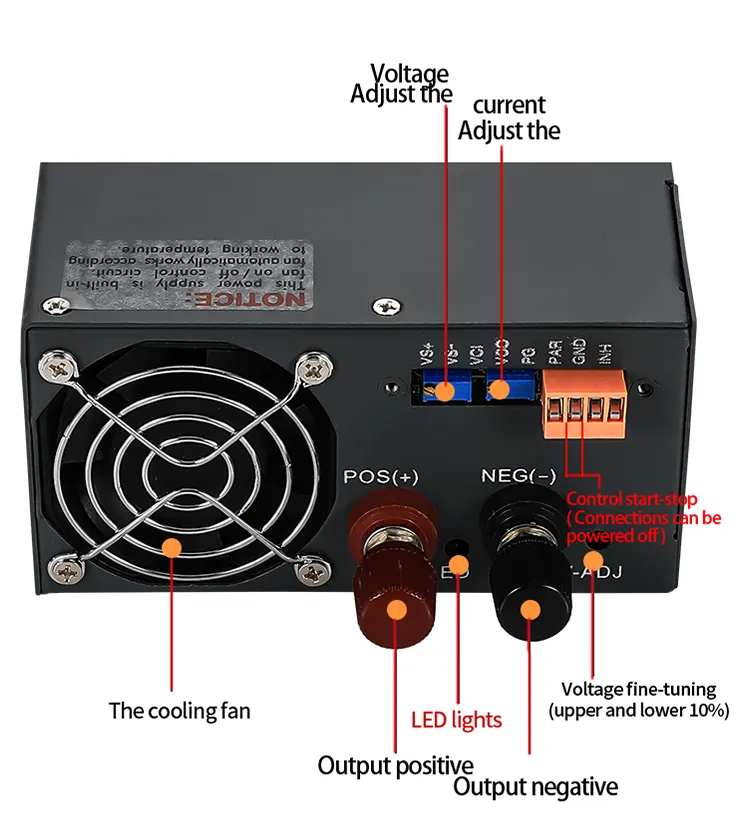

There is a connector for start and stop signal… but don’t know what to do with it.

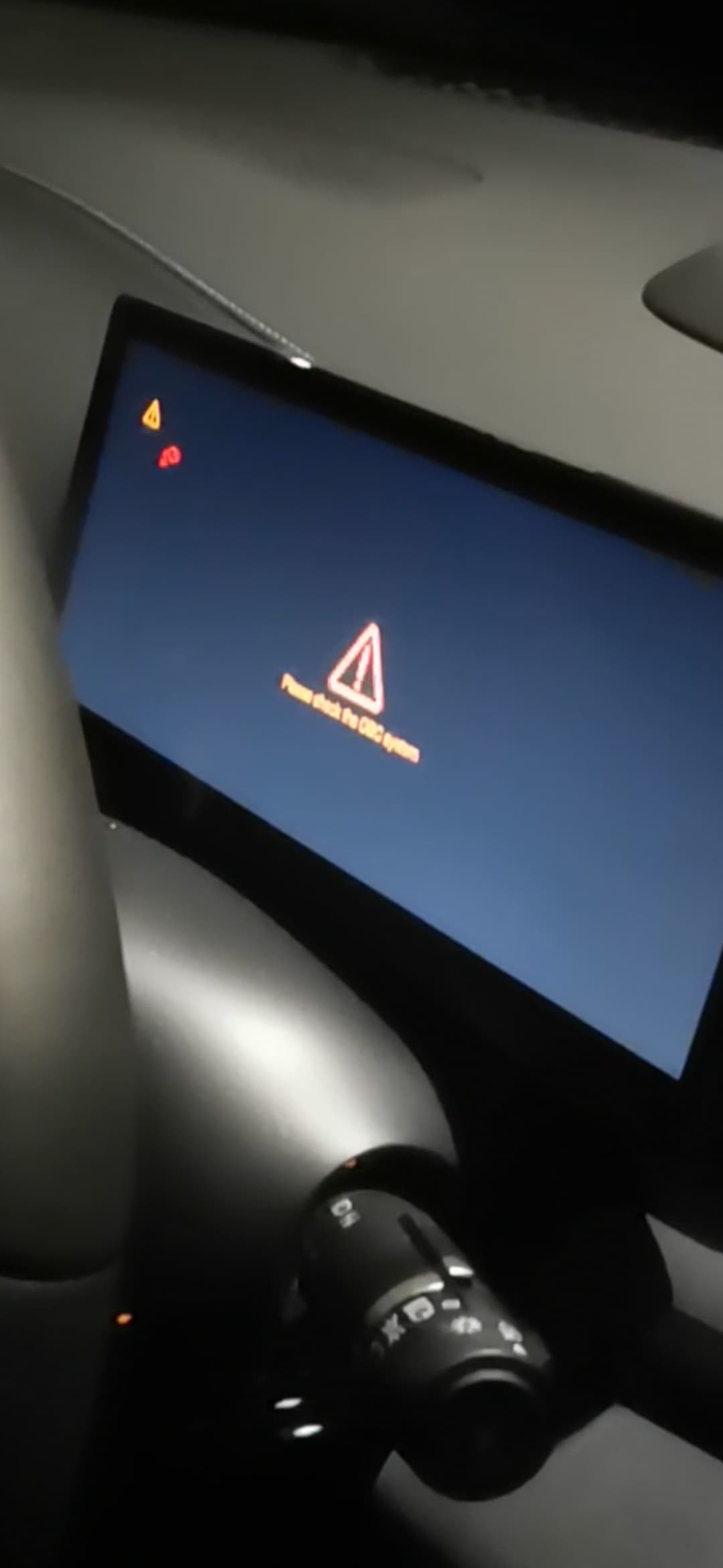

Today we connected the car to the inverter.
As you predicted the car turned off after about 5 minutes (guess it was the 5 minutes the inverter needed to start up)
It showed an error message and just turned off
Do you think there is something about the connection that can be done to fix this? Or by adjusting voltage and amps of the AC/DC converter?

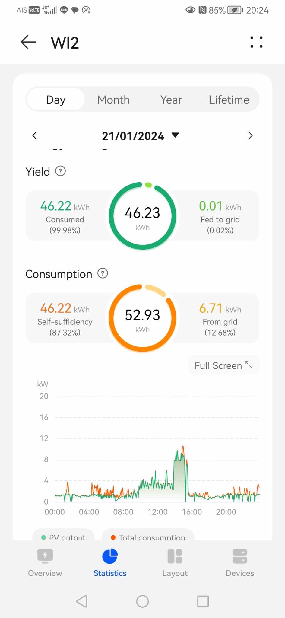

Update: Today I managed to get it to work for almost 3 hours before it turned off.
I started to import VTL just before the inverter turned off at 6pm, and it kept running stable till the car turned off again at 9pm.
I think I’m somehow getting closer to solve the problem without even knowing what causes it :slight_smile:

I experimented with different tweaks (lower-higher voltage, lower-higher amps) for a couple of days now, and today i seem to have found the right settings. It is working since over 4 hours now and seems to do just fine.
I drastically reduced the amount of amps by about 5 turns while leaving the voltage where it was originally (i guess 220v, but my converter does not have a display, so I can’t tell how much it is exactly)
I just get 1 KW, but it’s stable. If it runs all night without problems, tomorrow I will try to gradually increase the amps and see how much i can get before it fails again.

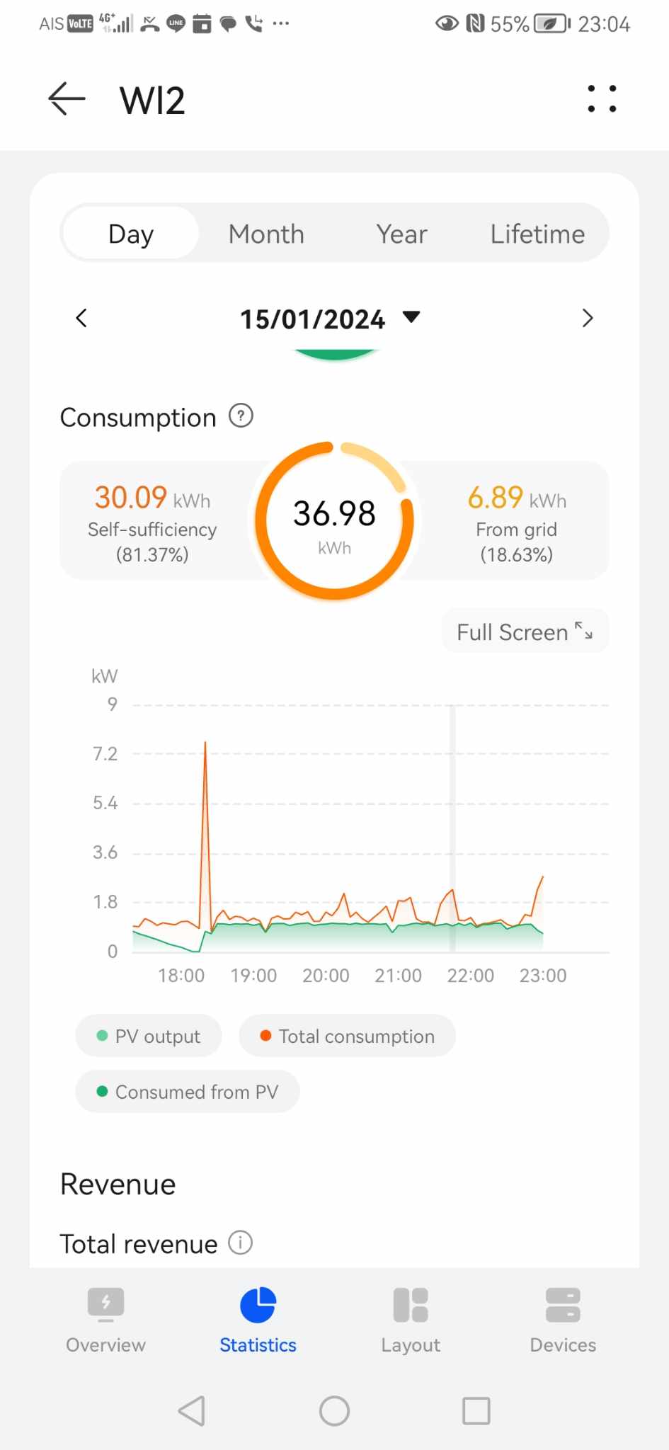

update:
It did run all night at constantly 1KW. :slight_smile:

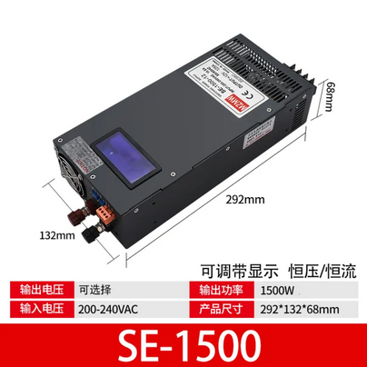

I purchased an other Power supply, but this time 1500w and with display to see the voltage and the amps.
Since I installed it, the system runs smooth at near 1.5 KW all night.
The battery of the car is used down to around 80% for one night and recharged again within 3 to 4 hours during the day.

What is the new power supply exactly. Is it the same brand but just a smaller 1500w unit?

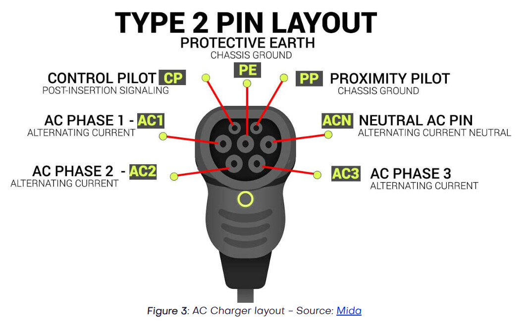

The automatic switch between the charger and V2L will not be easy, but it would be technically possible. You would need a four-pole contactor with 2NO/2NC. This would switch the AC connection between the charger and V2L. However, you would also need to switch the PP pin to earth link via the inline resistor. (The resistor is needed to engage V2L mode - https://perform.discoursehosting.net/uploads/db8135/original/2X/0/054129d90a6df2481ed01e9e1b896a4ad2257fde.jpeg)
Yes, its the same brand, but the SE instead of the SK version. (comes with display that shows voltage and amps).

I assume the Type 2 cable in the image you sent me is connected with a single phase charger, right? But why is the PP (proximity pilot) not connected? Is it just a secondary ground for CP?
And the resistor has to be 110 Ohms with 0.1 tolerance, right?

No worries. It’s been very interesting following your progress. Yes, single-phase charger. I don’t think any BYD vehicles have 3-phase charging.
With BYD, the PP pin is not required for V2L. I’m not sure why, but that’s just how they determine whether the V2L adapter is connected.
The resistor value is 2k Ohms. (I also measured it to double check) Sorry, the colours in the photo are a little hard to judge. You can see the full details here… BYD Atto 3 V2L load testing - Vehicle-to-load power output
