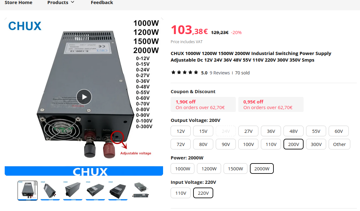

Alternative - which may be better or easier
Buy a chinese 240V AC>DC 220V converter 1500Watt or higher
and
Victron MPPT 250V / 70A CAN-bus charger + AC/DC converter
this variation also charging the battery but in managed way from Cerbo GX via CAN bus of the MPPT charge controller. The MPPT gets the power from the Chinese AC/DC converter which is powered by the BYD car V2L.

I have been researching this topic for a while and decided to go the “power supply into MPPT charger route”
This is the way I wrote as alternative. The chinese 240V AC>DC 150V 20A converter arrives only in May from China so I cant give any quick info but as I read people started using this way.
They either connect the converter DC side to some existing hybrid or whatever inverter or one use a Victron MPPT charger. The most important thing for me is the smart battery control, BYD battery can control the Victron MPPT charger via CAN bus.
