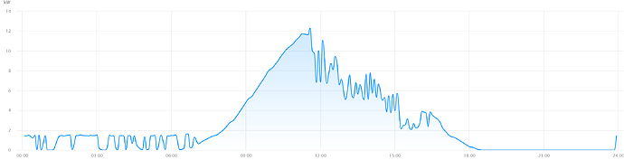

Hey @alain @Svarky - I have a BYD seal and have wired the BYD v2L cable provided into BOTH gen inputs of our TWO DEYE hybrid 8kw inverters (10.4kw Solar PV each) through a 15amp breaker.
We then tell the DEYE inverter in the settings to limit the gen capacity to 2kw in the software (Even though BYD advise me it’s a 3.3kw limit actually) … and we do not connect the ground cable in the V2L cable through our breaker as for whatever reason this causes the system to not engage.
Strangely we find the same symptom as you … it operates fine for a couple hours providing about 1.5-2kw … but after a time (sometimes 20 minutes … sometimes a few hours ) there is a browning or flicker of lights (say if the aircon kicks in) and the V2L stops supply.
DEYE technical have shown me charts that suggests the V2L isn’t kicked out and instead it’s voltage at the input simply drops from 220V to 5 V … ie deye says it’s BYD issue.
BYD says - is there a problem with your car ? No? Then we are not interested …
So now I am stuck … because the plan was to buy this car to use overnight to protect the fully charged house battery … so that we had enough (20kwhr) to kickstart the distillery in the morning before the sun truly got the PV pumping …
PS @alain why did you go for only 1.5kw converter when you could go up to 3.3… or at least the 2.4kw stamped on the V2L cable ?

My problem is still this instability … and I can’t seem to get to the bottom Of what’s causing it … some nights it will run for hours and other nights it kicks out after but a few minutes and eventually this behaviour coincides with the car going to sleep !
You can see here the saw tooth profile of my V2L kicking in and out through the night as it charges the house battery (slowly) and runs the (minimal) loads through the night
