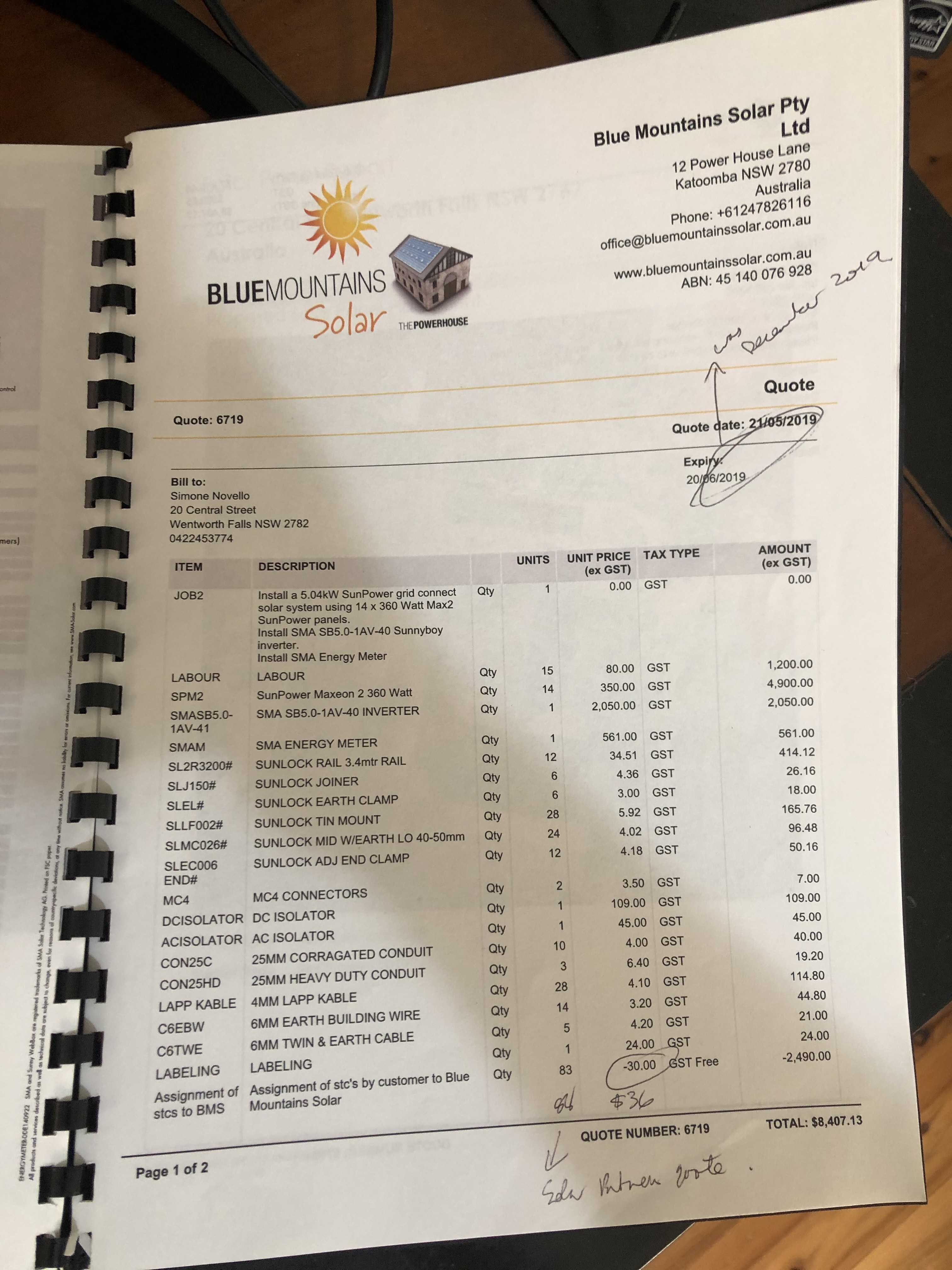

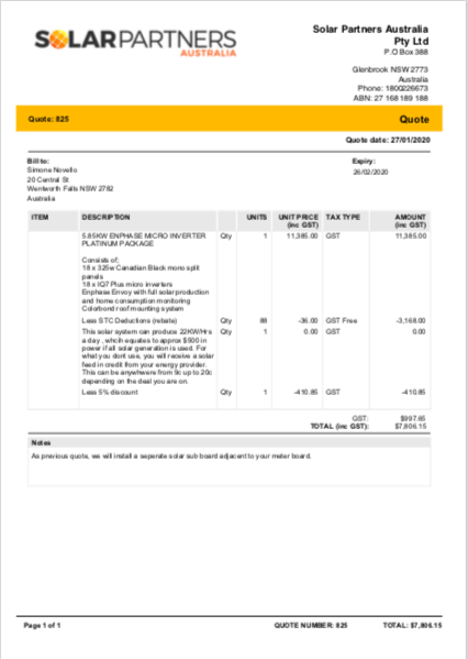

Hi there, I have two quotes and one particular installer I prefer as they’ve been way more responsive than the other company. When I asked the other company why their quote was so much dearer they replied that it was the difference between getting an Audi and a Holden and that was it. After that they have simply not answered any of my questions. I’ve now done my own research and can see that they have recommended most of the top of the range components however the Solar Partners quote seems like the better solution for us. Our roof layout is a bit weird and we do have some big trees on ours and the neighbouring property so there may be some shading at certain times of day. Would love an expert opinion though.
Hi @Werona
Yeah I agree, the “Holden” may be better here. It’s a very poor analogy in this case, because it’s actually SunPower that is reportedly in financial trouble. That, along with the shading, makes the Enphase/Canadian system a better option in my opinion.
