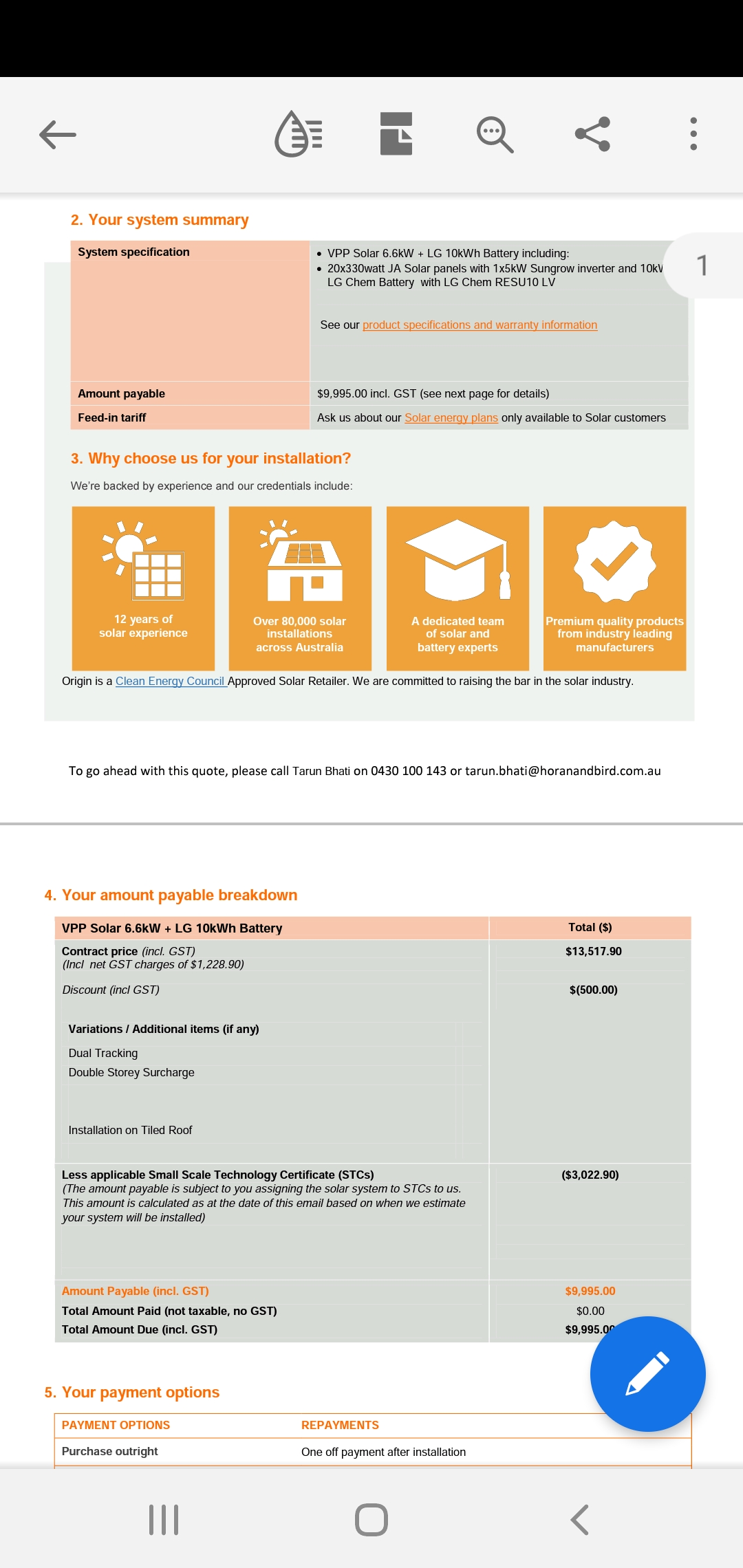

Thanks for crunching the numbers. I have received an updated quote for a 10kwh battery for $9995, am not eligible for state govt rebate of $1850.
Whilst i agree that storing power may not make me self sufficient, however after doing some hunting, the amount i am spending for VPP is comparable to panels only quote from other companies. I am just assuming that i may be in a slightly better position with a battery since i will be able to use power from Battery at night as opposed to the grid!!!
