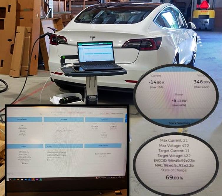

Exciting News! Last week, a 3-year-old Tesla Model 3 was successfully tested using a V2H/V2G bidirectional charger without any vehicle modifications. The test was performed by Finish company InterControl using German-made Ambibox bidirectional charging technology. The collaboration of these two innovative tech companies has potentially transformed what we know about Tesla & BYD’s true capabilities in regards to vehicle-to-grid (V2G) and vehicle-to-home capabilities. Ambibox also successfully tested a BYD Atto 3 using the same Bidirectional charger (refer to post below).
Tesla’s V2G capability confirmed
The discovery occurred about one week ago (3rd July 2024) and was announced on Linkedin by Timo Kulkki, a Product Manager at InterControl.
This is a quote from the post: "You can imagine the surprise we found in the test; Tesla 3 is bidirectional: changing dynamically from charging to discharging, discharging around 5 kW power without any problem, and here are only the sample fotos from SoC 73 % to 69% and still going strong… "

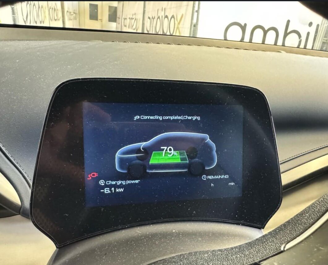

BYD Atto 3 bidirectional DC charging
The same company, Ambibox, also tested a BYD Atto 3 using the bidirectional charger, and it worked successfully, discharging up to 7kW. This confirms that BYD EVs are also capable of V2H and V2G using a compatible bidirectional charger without any vehicle modifications.
Here’s the link to the post from Manfred, the CEO of Ambibox in Germany.
Digging deeper into the discussion thread, it was revealed the system was externally controlled via the HEMS supplied home energy management system. However, it was also mentioned that it works with OCPP, which is more universal. BYD has clearly implemented the ISO15118-2 standard.

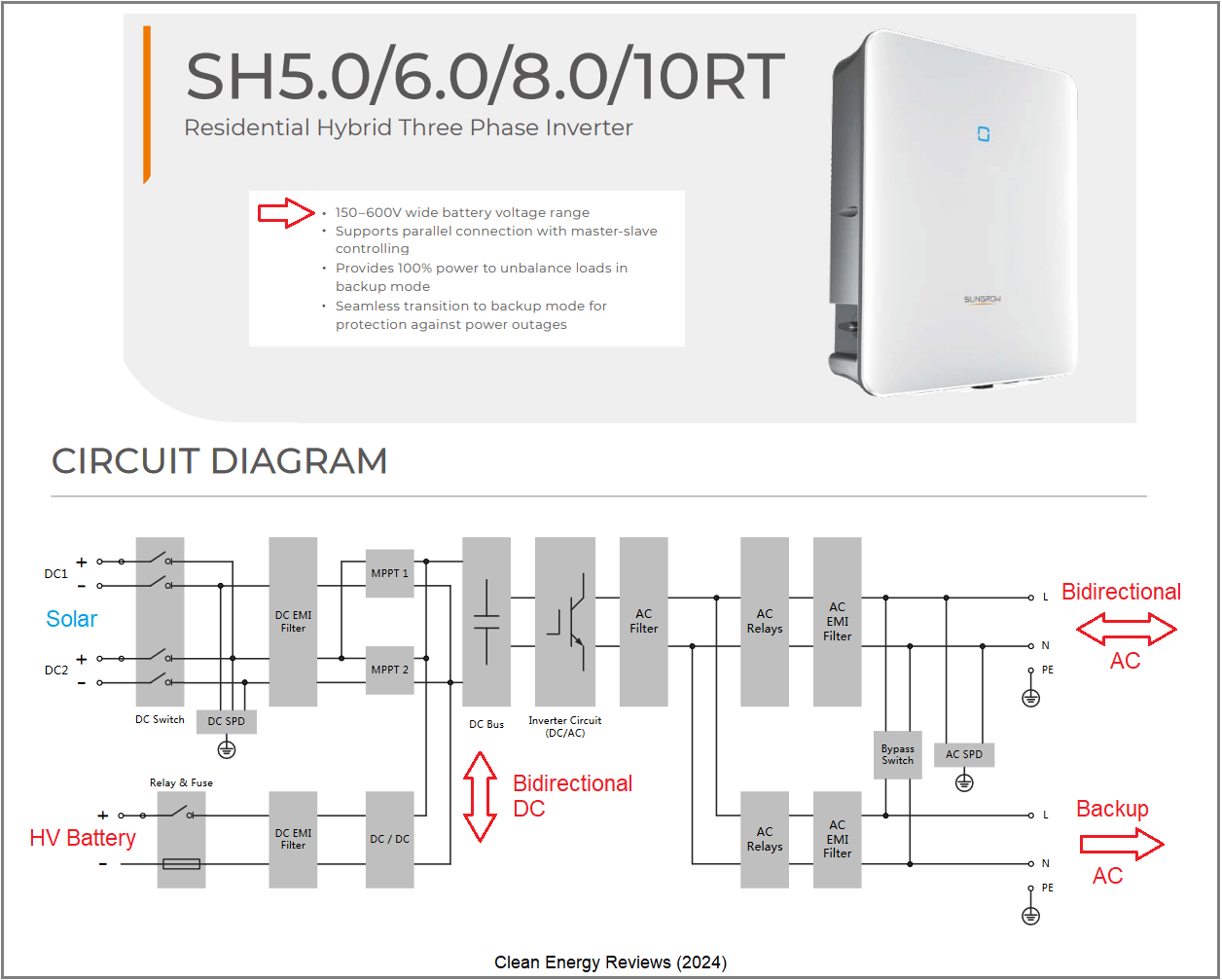

Most people don’t realise many affordable bidirectional Hybrid inverters (of the high-voltage or HV variety) work almost exactly the same way as a bidirectional EV charger, except they charge a stationary battery system instead of an EV battery.
Hybrid inverters seamlessly transition between charging and discharging with milliseconds, as well as solar energy conversion. We have been installing them for years, and they are becoming more affordable all the time; a 6kW bidirectional Hybrid inverter, such as the Sungrow SH6.0RS, costs as little as $2800.

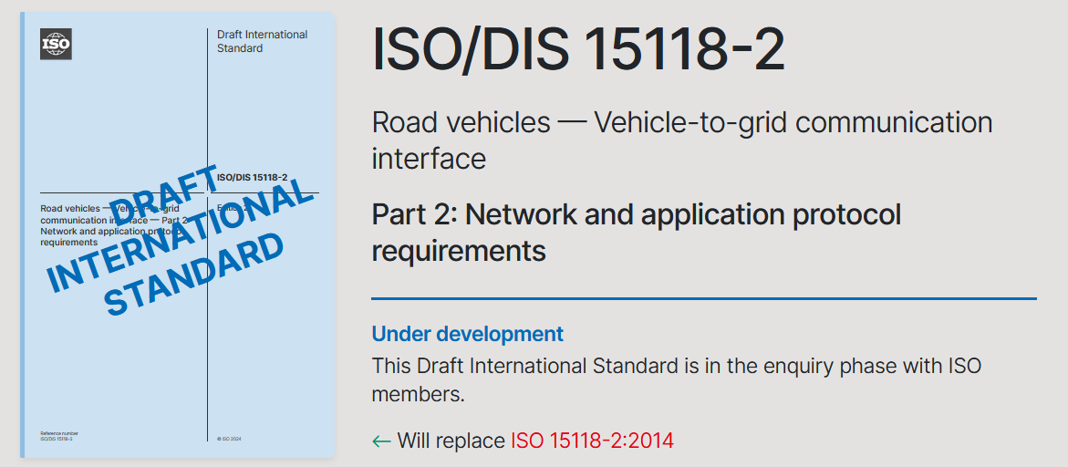

yes, exactly, and did you notice the home backup industry is moving away from 48V batteries towards high voltage home batteries. I would not be surprised V2X drives this. One thing missing still, the communication between the EV and the home energy management system. For that one could use some opensource Raspberry Pi solution too.
Yes, true. There is a growing number of HV inverters and battery systems, but 48V still has its place in the home energy storage market as it’s much safer and user-friendly.
Agree, the vehicle communication standard is the main problem, but that’s being addressed with the new version of ISO15118-2 Vehicle-to-grid communication interface.
