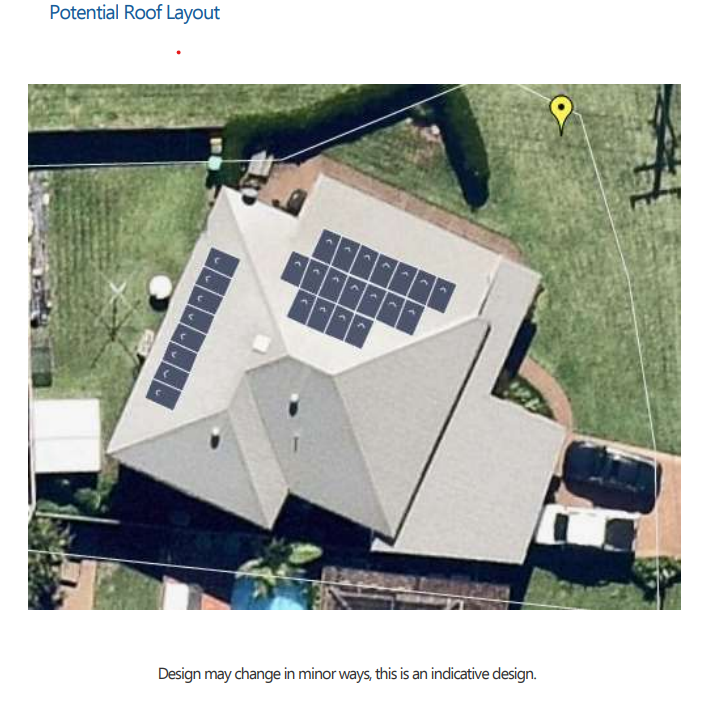

We have from a local company the quote below. Picture is included. Roof aspect shown with 18 panels is NE and that with 8 panels is NW. there will be no overshadowing on those roof aspects. Quoted price is $9410 after STCs. We could have JA panels instead for $750 less.

Sungrow and QMAXX is a good low cost option I reckon. That price is maybe a little bit more than what I’d expect, however it’s good that they have included the solar analytics, and if they are a really good reputable company, then that’s worth a premium. If I was you, I might see if they could trim that price a little though.
