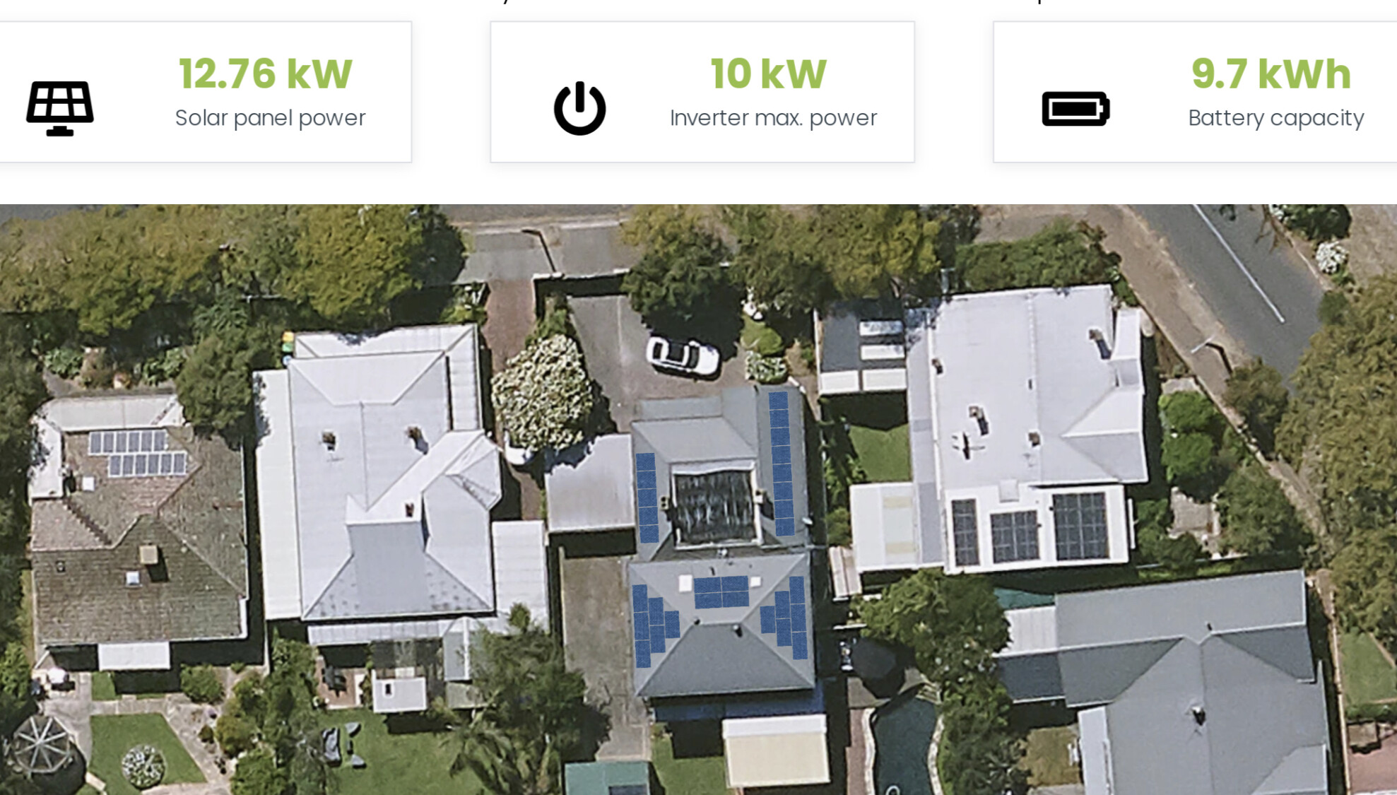

Do you have a roof layout diagram from the quotes? It sounds like a very complex and challenging installation, hence the price and the SolarEdge option.
I would get solar and leave the battery out for now. The payback for solar can be as little as four years. Or faster if you can adjust some appliances to operate during the day. For example, run your air-con using a timer or App (for free) during the afternoon and arrive home to a cool house. And of course, charge the EV during the day and on weekends.
A battery can be added at a later stage if needed.

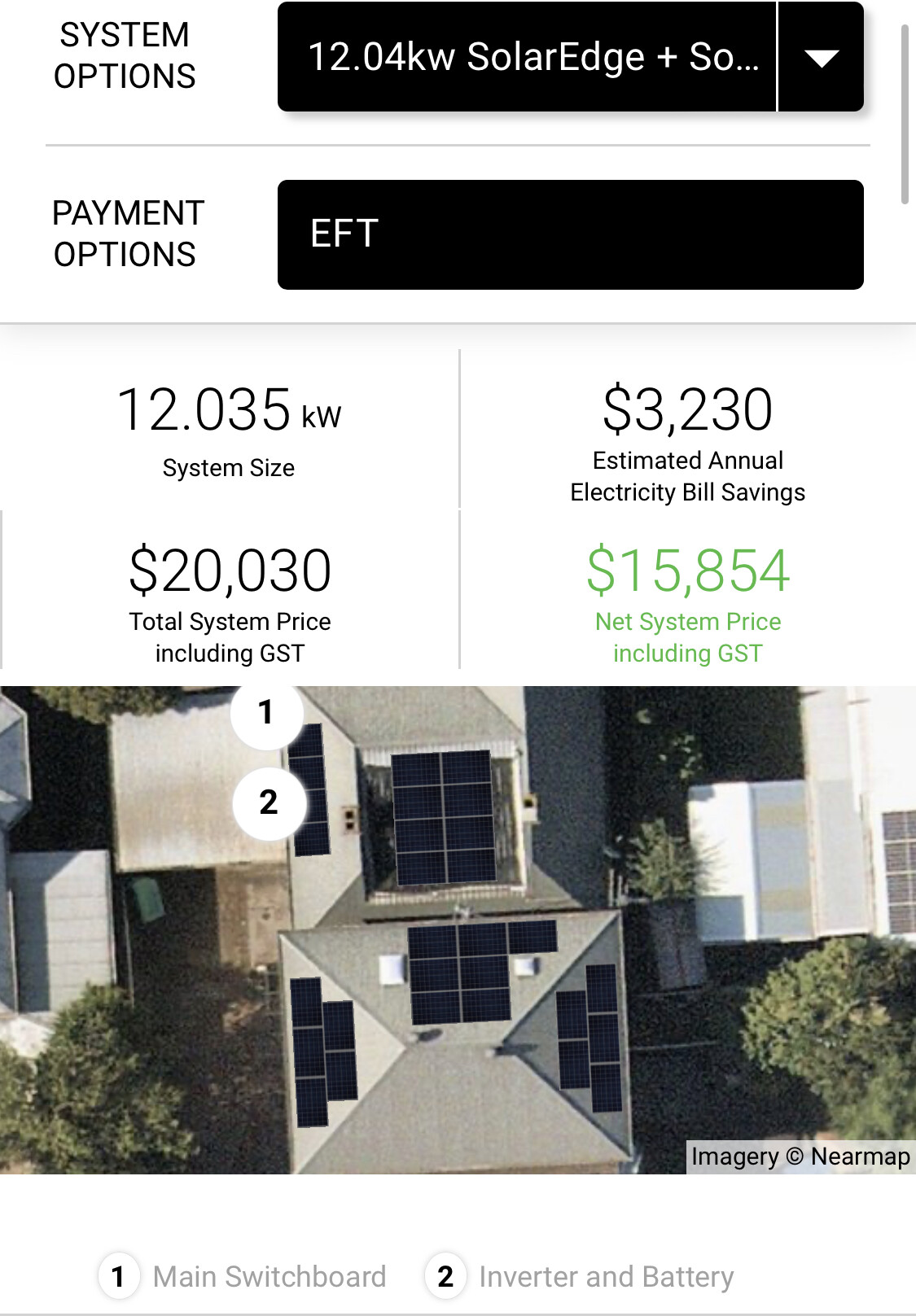

Here are the roof layouts for the 2 quotes. The 45 degree pitched roofs are the east and west facing sections at the front of the property (property faces north)
Thank you, that sounds like the best option (getting solar panels without battery for now).
The 2nd quote comes down significantly to $15854 without the battery and EV charger.
Would appreciate any further thoughts on whether these quotes seem reasonable after seeing the roof layouts.
It sounds like neither are a bargain so It would be worth getting a 3rd quote before locking anything in.
Yes, that’s worse than I first thought. That is a very difficult installation on multiple steep roof pitches, which must also be interconnected. Considering the size and complexity, I’d say your quote is quite reasonable.

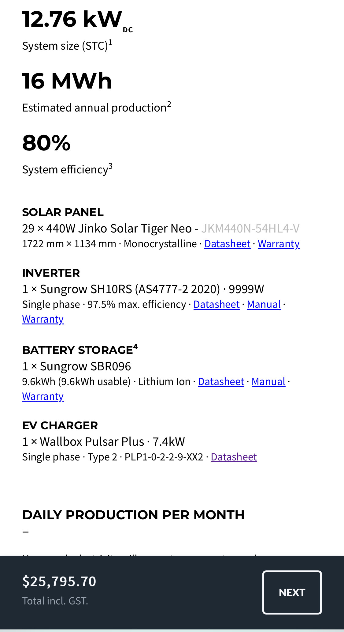

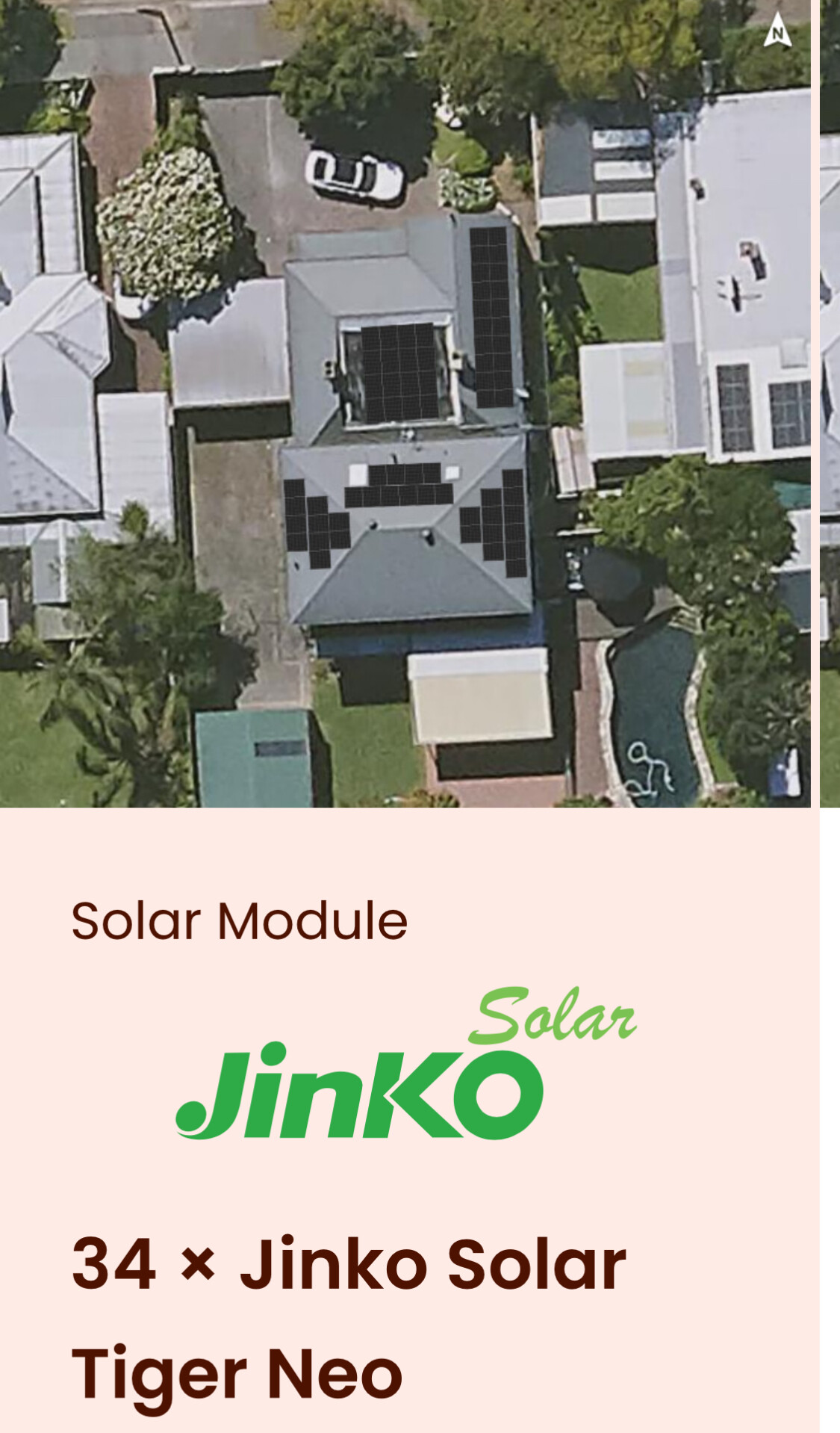

Thanks for all your help. I’ve just got the 3rd quote and it turns out to be $4-5k cheaper than the others.
It’s using cheaper parts but I think they’re still reputable brands so now I just need to decide whether 12.76kw is big enough (I think it should be) or if I want to go a little bigger just in case. We do have 3 kids + a pool and spa so the bigger option is tempting.
Before I lock it in.. is there anything obvious I’m missing or should be concerned about here?
I’m told the Sungrow batteries are also a stackable design, so I can add additional 3.2kWh modules if needed for around $2000
Looks good. The Sungrow system is a great option, but whether it will be large enough for your needs will probably depend on how often you want to charge your EV using solar. It sounds like your household loads will be quite high already.
