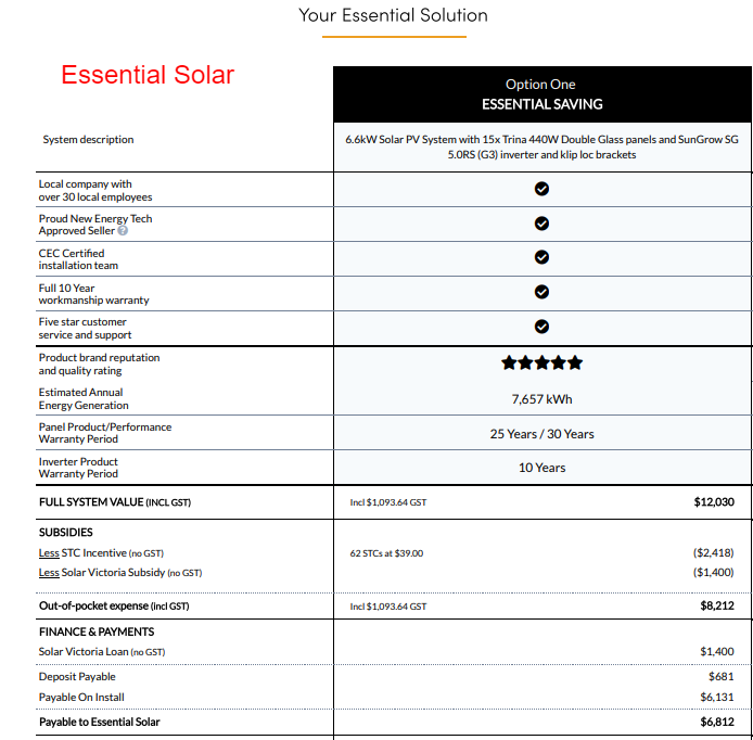

I am looking to invest a mid range system and i am not quite sure how much i should be expecting for out of pocket.
I understand i may not save much since mainly at home in the night time, but i think if i can manage the electric usage to run in day time, at least half of my current usage can be reduced.
And of course i would like to have AC freedom during summer and nice warm house during winter mornings :stuck_out_tongue:
Quote 1: (Really too expensive imo)
Quote 2:
Qyote 3:
Quote 4:
Quote 5:
I have been offered other brands Risen panels and GoodWe inverters but it seems like the more popular choices are Trina/Jinko and Sungrow. Is there any recommendation other than Sungrow?

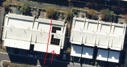

In all the quotes I have received, the placement of panels are all different. Is there any specific placement a house should install?

And a rough image of my roof:
It’s good that you have done your research and obtained many different quotes. The first quote is more expensive, but they offer the best inverter and panels and will no doubt do the best quality installation backed by 10-year workmanship warranty.
I would avoid quotes 2 and 3 since they offer very cheap Growatt inverters and dirt-cheap Seraphim panels. They are based in QLD, where are you located?
Quote 4 seems very reasonable and has good panels and inverter. Best value option.
Quote 5 isn’t bad but I’m not a big fan of Risen panels.

Ok, I would go with quotes 1 or 4. Whichever you can afford
