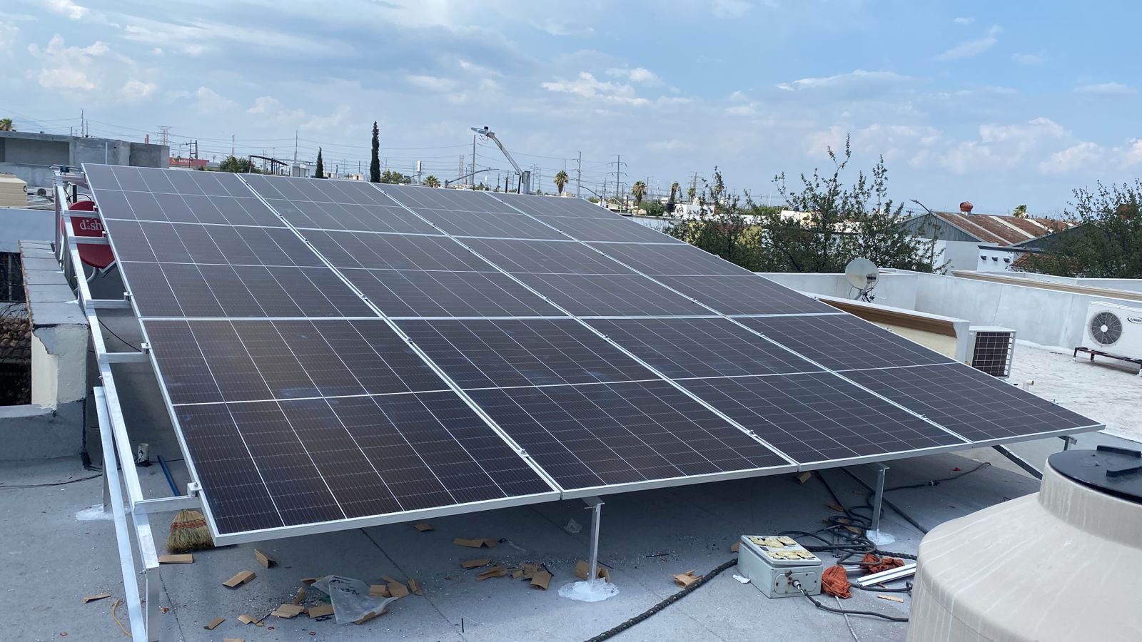

Thanks for your answer, I forgot to mention that the installation would be done on the roof of my two-story house.I will try to attach a photo of the installation.
I am very happy with the results and although I still do not have the DTU to monitor (supply problems), from my meter readings and some consumption calculations, I can say that the arrangement generates more than 40kwh on days that are favorable. Not too bad.
PS ignore the dish antenna, it is no longer in use.
