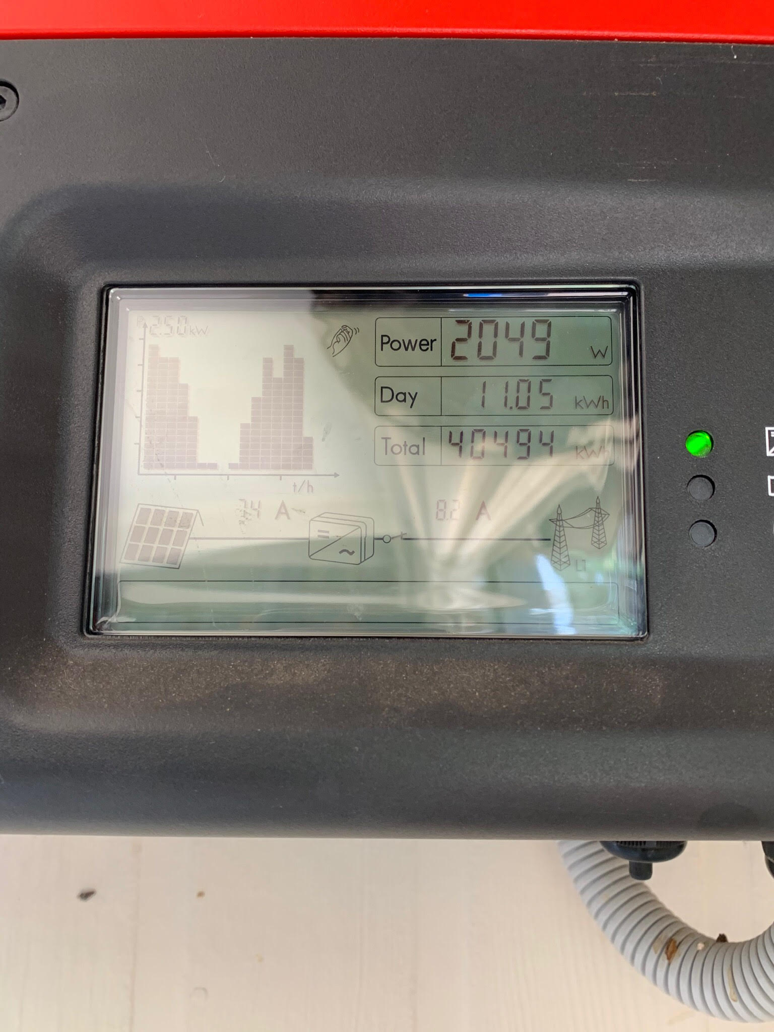

  • Our daily usage averages between 18 - 26kw per day depending on time of year and vacation absences, but that figure does not take into account what we consume from our current solar as ther is no way to monitor it.
  • Producing 2 to 2.6kw (See below - that was Midday on an overcast day)

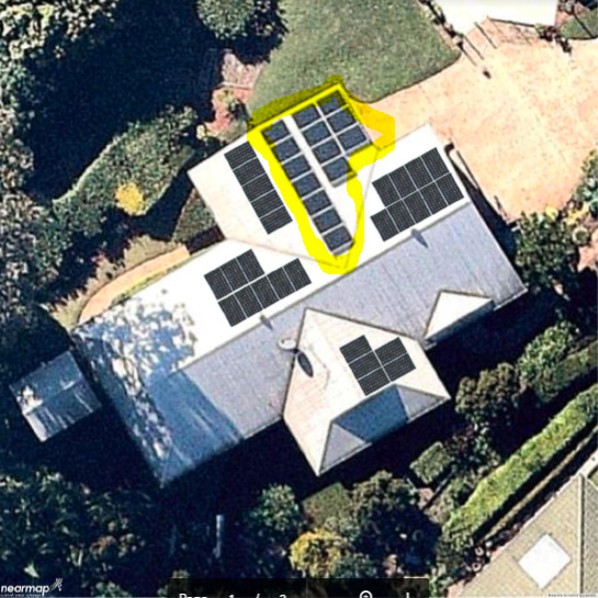

I contacted the supplier of the first two quotes asking him to rework the quote with us keeping the old system. Below is an image of the reworked roof layout he sent me today with a new quote. The yellow panels are my existing system.
He’s added another 5 panels now (I didn’t ask for the extra panels this time around, so not sure why he did that). But because there are more of them 27 now (SolarWatt - Vision 60M 295W) instead of 22, the final quote with the original SMA 6kw inverter is now $9999. Ill be calling them tomorrow to ask why the extra panels. Maybe he’s trying to cater for the future AC units, but like you say, if I only manage to reduce my bill to $100 bucks a quarter It’s still a win. Does $10k sound Ok for this system
Also - what is your opinion of the SOLARWATT panels? Their warranty is certainly impressive.
Peter
Hi Peter,
I think that looks ok. I can see why they wanted to take down your old system, it’s the only way to sell a bigger new system.
You could definitely get that system cheaper, but you also often get what you pay for.
