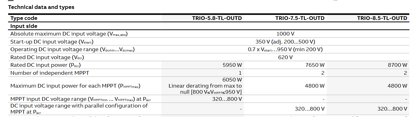

Nothing wrong with the ABB inverter. The problem is the string 1 voltage is way too low and well out of the required MPPT range of the inverter. String 1 will not be doing anything hence why your generation is so low. The total solar generation should be well over 35kWh per day.
This is due to extremely poor design and configuration of the strings. Typically of sales companies who have no adequate training. This needs to be re-wired to work properly. How many panels are the other roof faces?
Refer to the MPPT voltage range in the bottom right hand corner of the ABB spec sheet. As you can see the string voltage (when operating) needs to be above 320V to work correctly.

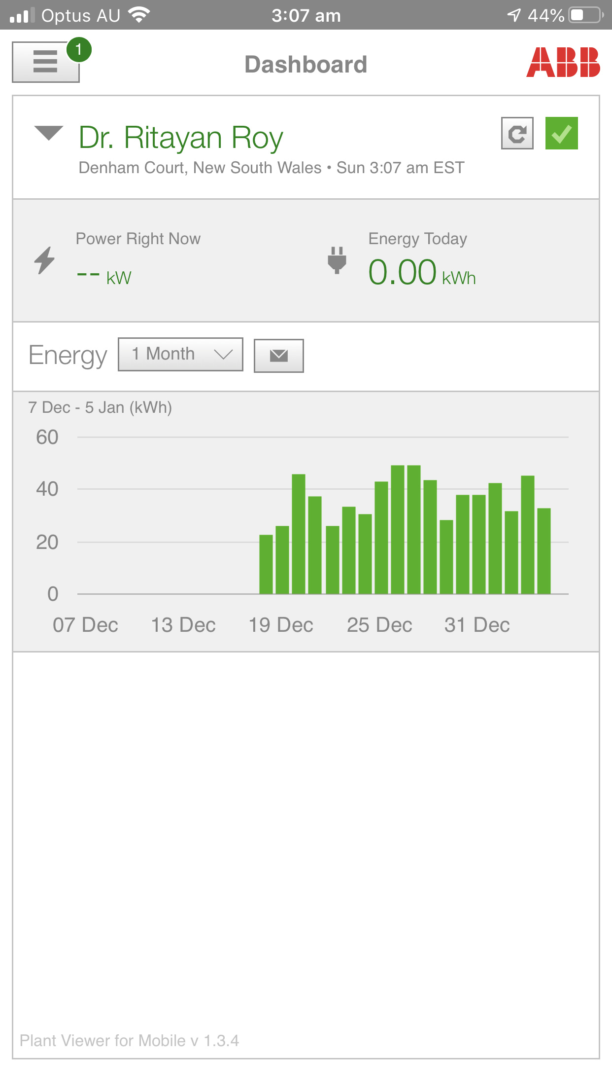

Just wanted to thank you all. The installer has forgot to turn on the switch of one of the strings on roof.
A bit of dust and ashes made it less efficient production. I attach the screenshot of the current power generation for last 2 weeks for the 7.9 kW PV system and would be glad to know expert’s opinion about the power generation is acceptable or lower than expected!
That’s looking a lot better now @royritayan.
