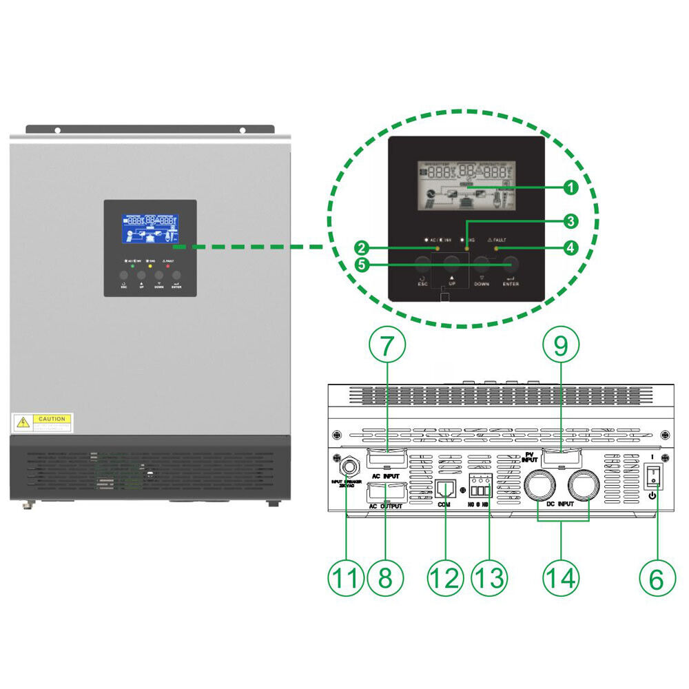

I neglected to respond to the inverter question, the unit is not branded so I don’t actually know. I’ve search online and matched the exterior to this
Sorry to break the news but those Voltronic inverters are not very reliable and are difficult to set up correctly. They also don’t have battery SOC (state of charge) controls so I’m not surprised you are having issues. You really need to upgrade to something more reliable such as a Victron Multiplus inverter and solar charge controller (MPPT) which will be able to charge a battery system correctly.

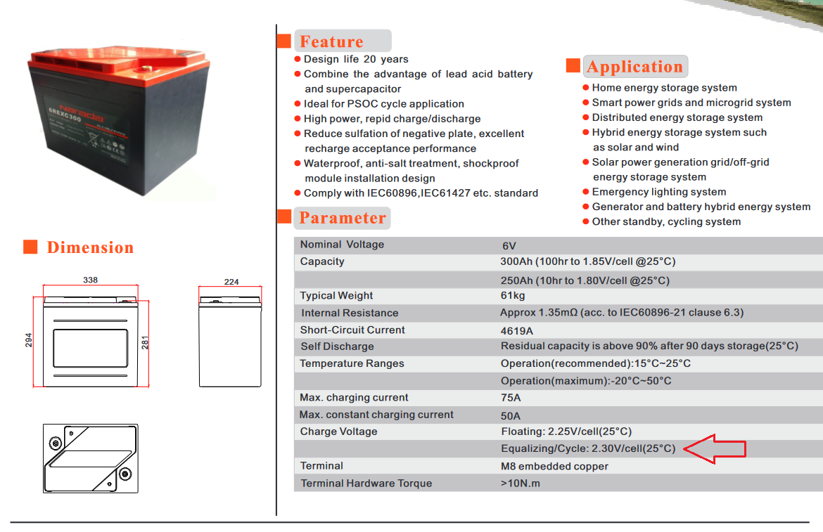

The charging (cycle) voltage is 55.2V (absorption) for these batteries as shown on the battery specifications. And 54V is the float voltage (2.25 x 24 cells in total).
If you never charged above 53 voltages then the batteries have never been charged correctly and unfortunately, this is why they have failed.

You will need to try charging them at 55.2 Volts for 2 to 3 hours using a generator or solar. This is the only way to see if you can save the batteries. However, if the temperature in the battery room/box is very warm (above 35 degrees C) then you will need to charge them at a lower voltage (around 54.6V)

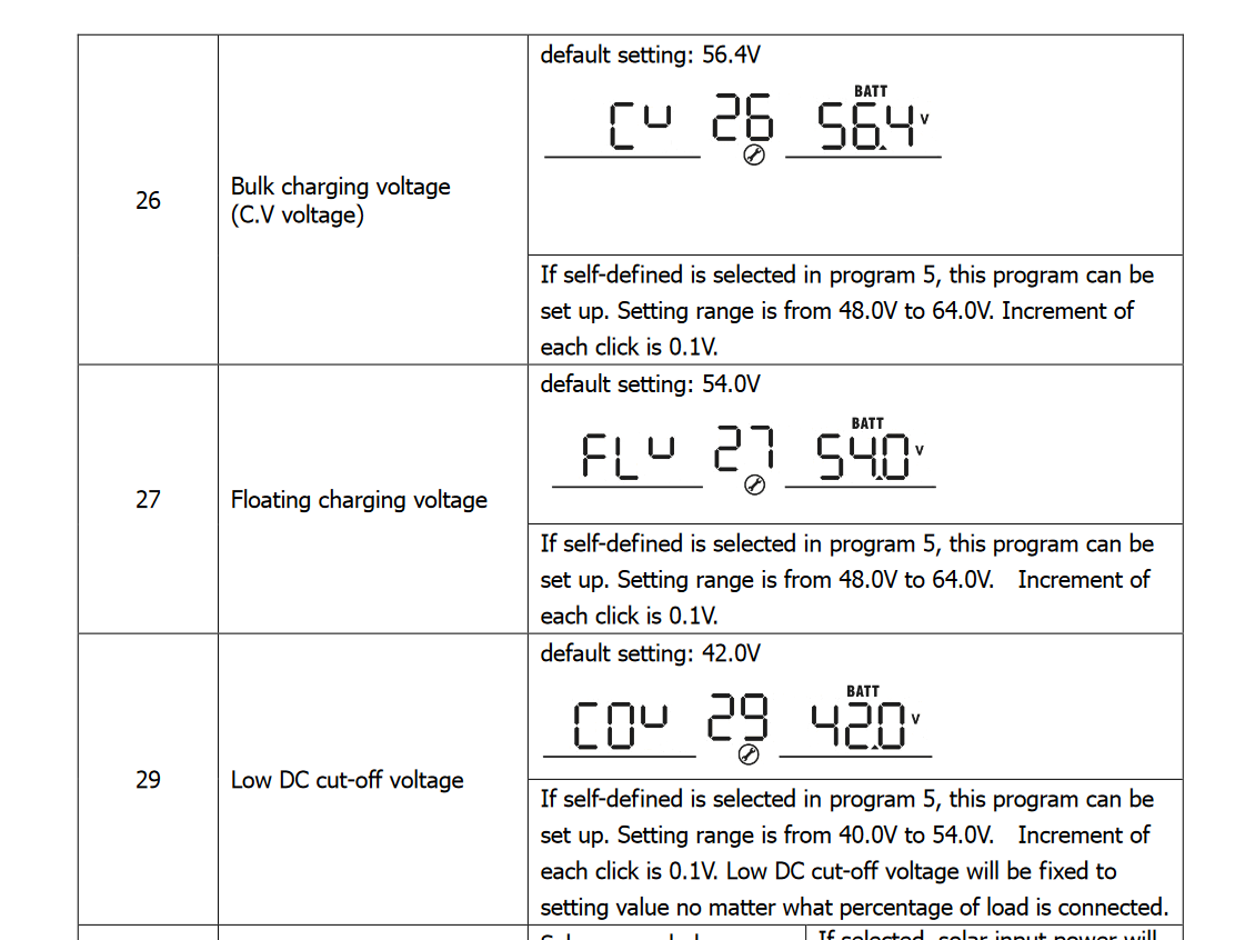

@Tracy, the charger (inverter) will hold the charge voltage at 55.2V but you have to program it correctly. The generator is just the AC power source.
Do you have the inverter manual? You need to change settings 26 and 27. Set the Bulk charge voltage to 55.2V and the float voltage to 54V
If you don’t have the manual, type this into Google and download the PDF file… “Axpert 5kva inverter manual”
