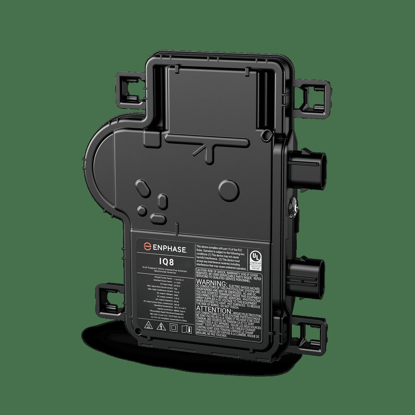

Is the Enphase 245W Microinverter (IQ8-60-2-US) the best choice for maximizing solar panel efficiency?
I’m exploring microinverter options and came across
the Enphase IQ8-60-2-US Microinverter. It’s rated at 245W and seems designed for seamless integration with modern solar setups.
What’s your experience with this model? Does it provide a noticeable boost in efficiency or performance compared to other microinverters? Also, how does it handle partial shading or lower sunlight conditions?
Would love to hear your thoughts or experiences before making a decision!
