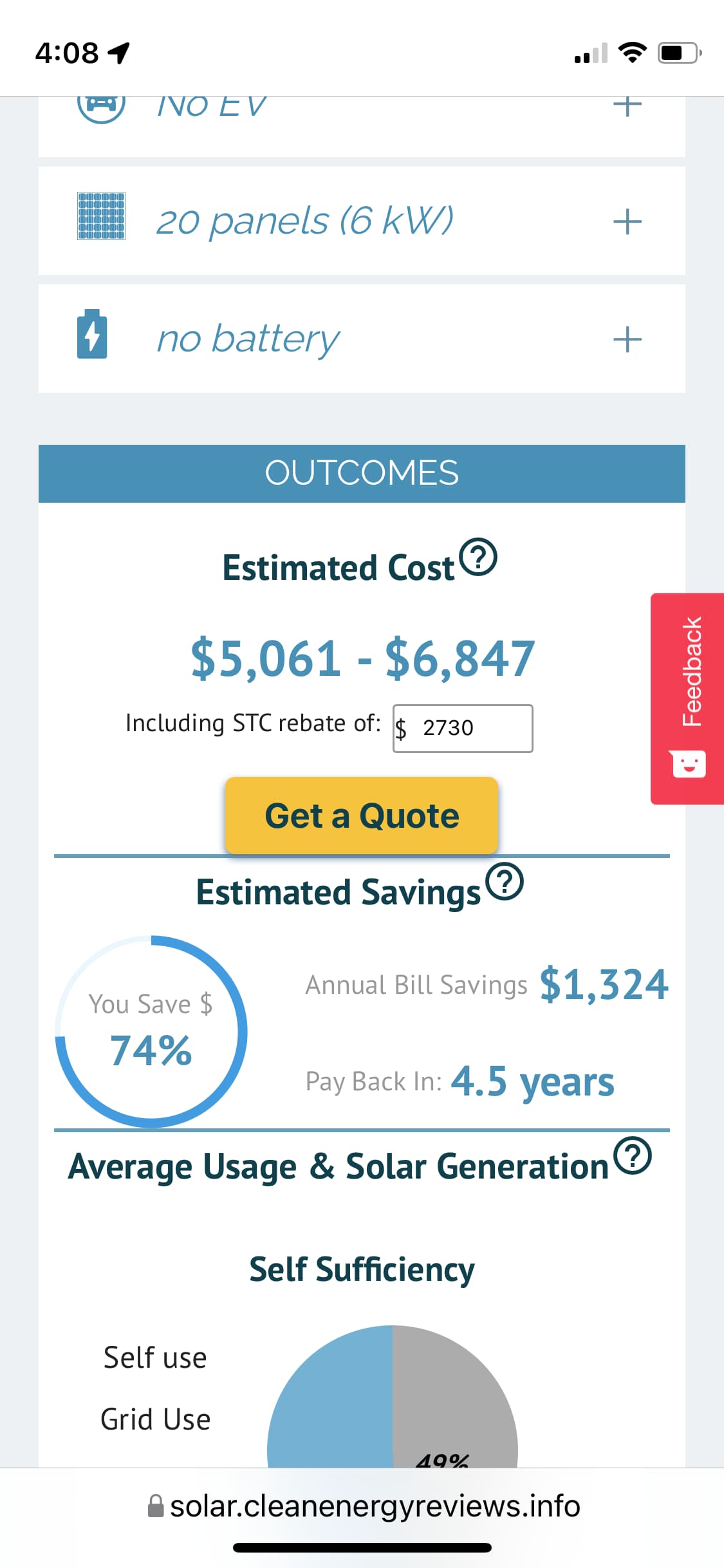

Yep, even less actually. Including the federal STC rebates people can expect a fully installed mid range system for $1AUD a Watt, or $1.70 will get you a premium setup.
Our AU calculator estimates a mid range 6kW system will cost $5 - $6.8k AU out of pocket.
