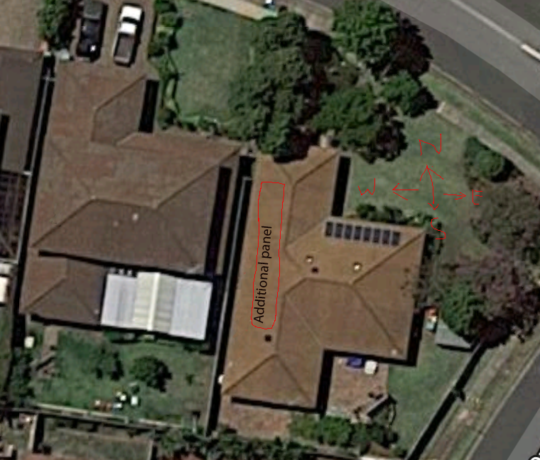

Thank you for your response. The reason I want to add more solar panel to reduce the cost of our electricity bill. We are based in Sydney NSW. We use almost 25KW/day. I have attached the photo of the house.
Neighbour’s house is two-story. Mine is single story. There’s trees on the border between mine and neighbour. The trees are in my property

Hen, it’s a tricky one. Would be good to get the installer to give you actual figures of the expected output based on reduction from shade. You could still produce quite a lot of solar, especially in summer months when the sun is higher in the sky. You are going to get a lot of shading in winter though. The installer should be able to give you an estimated payback period, then you can decide if it’s worth it. The shade will impact significantly either way, but depending on the extra cost of the optimisers, I would have thought they would be worth the investment. Again, really depends on the actual pricing and payback. I would suggest getting the installer to provide that info, share it if you like so we can help review, and consider getting multiple quotes as well so you can get a varied opinion on the shade impact and payback period.

The other reason the installer maybe recommending optisers before replacing all the panels, is to match the old panels with new ones. Personally I would look at a solaredge system with an inverter with a large enough capacity to move the existing panels across at a later date when your current inverter dies. So initially you would have 2 separate systems. But this would depend on the size and age of your existing panels. I would also recommend someone actually climb on your roof and measure the north face and load it up first and avoid shading from your neighbors.
