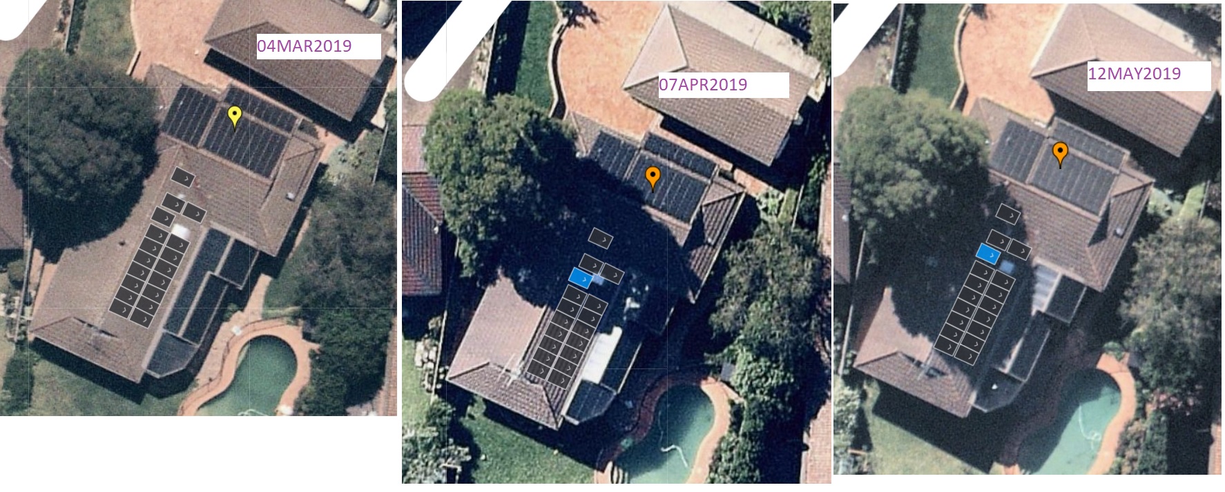

hi - have got quotes for 6.6kw solar (18 panels) - our consumption 20-25kwh per day. looking for value for money soln. On my north facing, pool heating is there so combination of west and east was considered as suitable location for panels. However, on my west roof, half the roof is shaded due to tree next to the house. The shading doesnt has much bearing in summer however will likely have material impact in winter/autumn including some on east side.
Two installers I spoke to suggested going for solar edge or optimisers to provide for the shading. I was thinking of having two separate strings so that the panels on the east can generate in the morning and the panels on west in the afternoon.
After reading the blog on solar edge - requiring minimum 6 panels not to be in shade - am not sure my above configuration of 2 separate strings for east and west works.
Open to suggestions on layout of panels and whether solar edge/enphase/tigo optimiser will work better.

Thanks Marty. Thats right - the east panels will only produce till say early afternoon.
The pictures above show east panels only but i am thinking of going 9 panels east and 9 panels west. West panels will be towards the back of the roof after whirly bird. In summer, there is no shade on west side however in autumn/winter there is shade on west side that moves between couple of panels to most of panels shaded and last couple of hours. For these panels on west, i was advised to use Tigo optimiser atleast and if possible go for solar edge.

Ah ok, apologies, I misunderstood.
6 panels on the west would probably work, but like you say, is it worth getting SolarEdge for that scenario given once the shade hits any panels on that string, the voltage will probably drop too low and the inverter will drop out anyway? It is hard to say. It’s probably worth getting panel level optimisation, Enphase ideally, but Tigo or SolarEdge is fine. The nice thing about panel level optimisation is that you’ll know exactly what is going on, whereas with a string inverter you’ll be in the dark, along with your panels.
