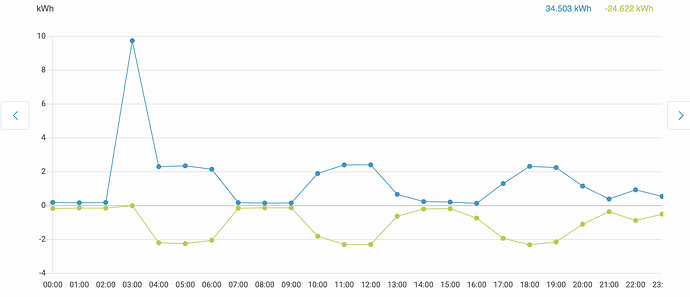

Long story short, I’m having an issue with, what my grid provider is calling, mirror consumption. Whenever the battery is being used for house loads, I can see that we’re not only taking that energy from the grid, but at the same time feeding almost the same energy to the grid. Easiest way to spot this is during the times when the sun is already set.

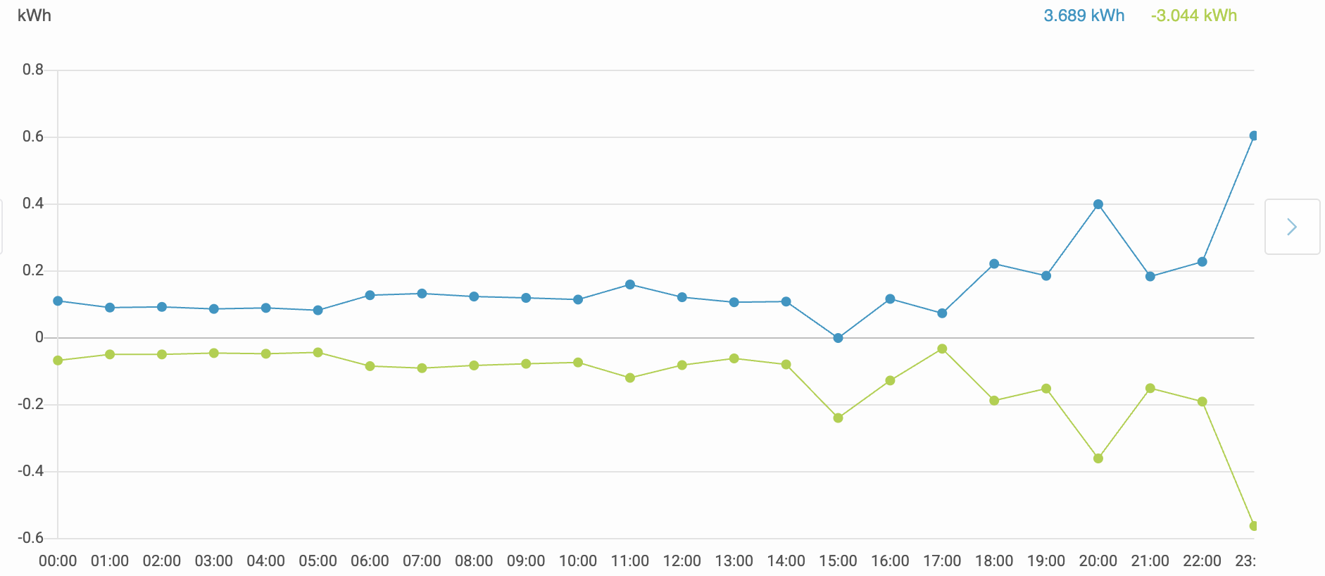

Blue is consumption from grid, green is feed-in.
The only way I managed to stop these insane feed-in spikes (for which I might even get fined by my grid provider, because my total feed-in limit is 0.8kwh) was to set feed-in limitation per phase at ~0.28kwh rather than setting a complete total at 0.8kw.

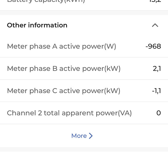

This is what I see constantly in the app
It is trying to constantly balance phases out which, I assume, is what is causing this phenomena.

It sounds like the CT clamp meters on the mains might be installed facing the wrong direction. It’s tough to know what is going on without more data and information. This is a 3-phase site with unbalanced loads, and I’m not entirely familiar with Sungrow’s operating parameters.
Have you contacted Sungrow directly about this issue? Sungrow tech support is actually very good at remotely analysing and resolving potential software or firmware issues.
