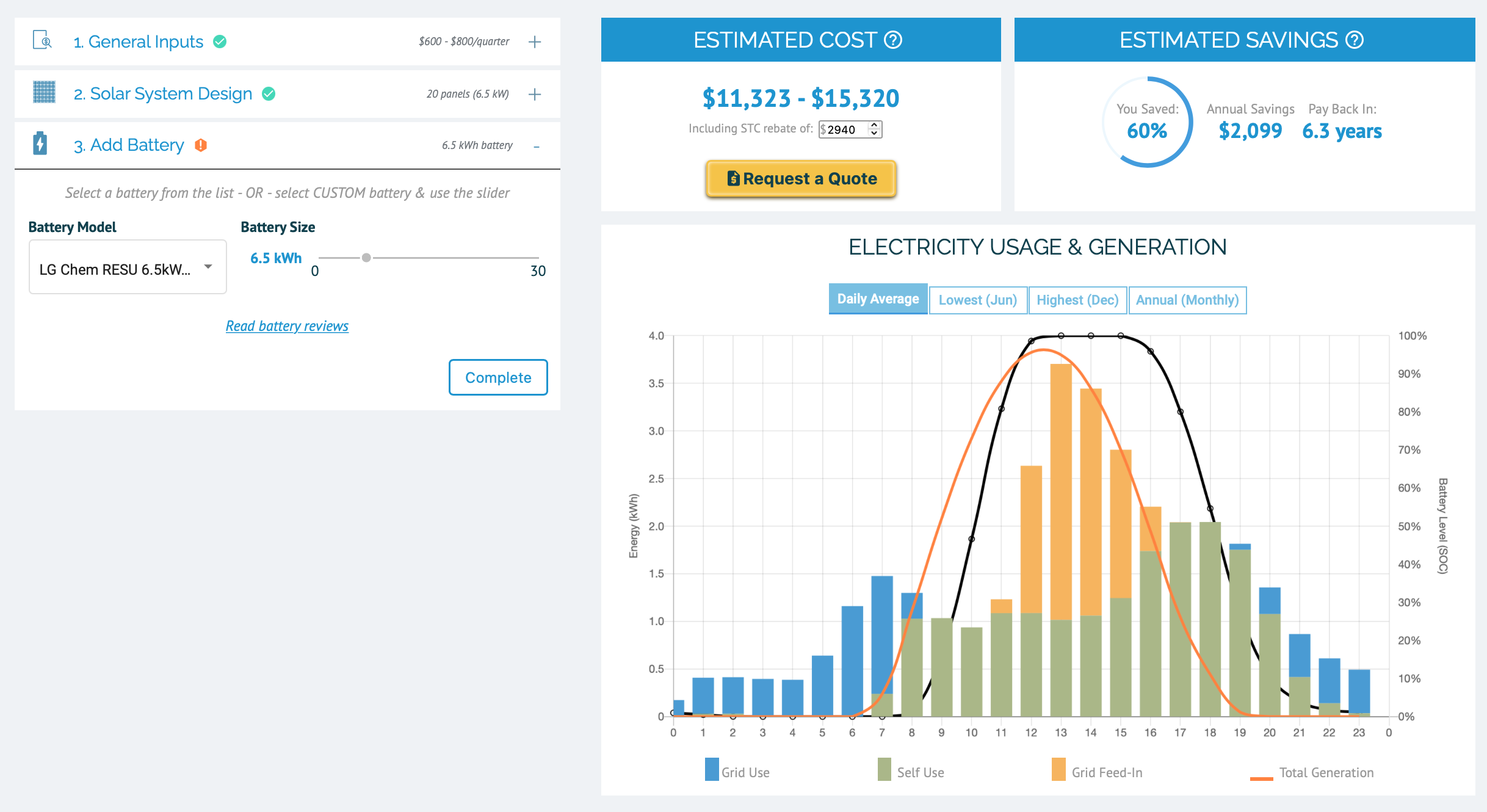

G’day @Keith2, welcome back.
Our Solar & Battery Simulator should be able to help you with the first two questions.

Ah, apologies, I misunderstood and thought your were removing the old panels. Makes sense what you’re saying.
I’m sceptical about this claim. I think you should ask for their calculations on this. Our calculations estimate you’ll save approximately $1600 just with solar. I think that’s more like “maximum” rather than “minimum”. If you ask for their calculations and they produce solid and transparent figures, it’ll help to find out what sort of company they are as well.
