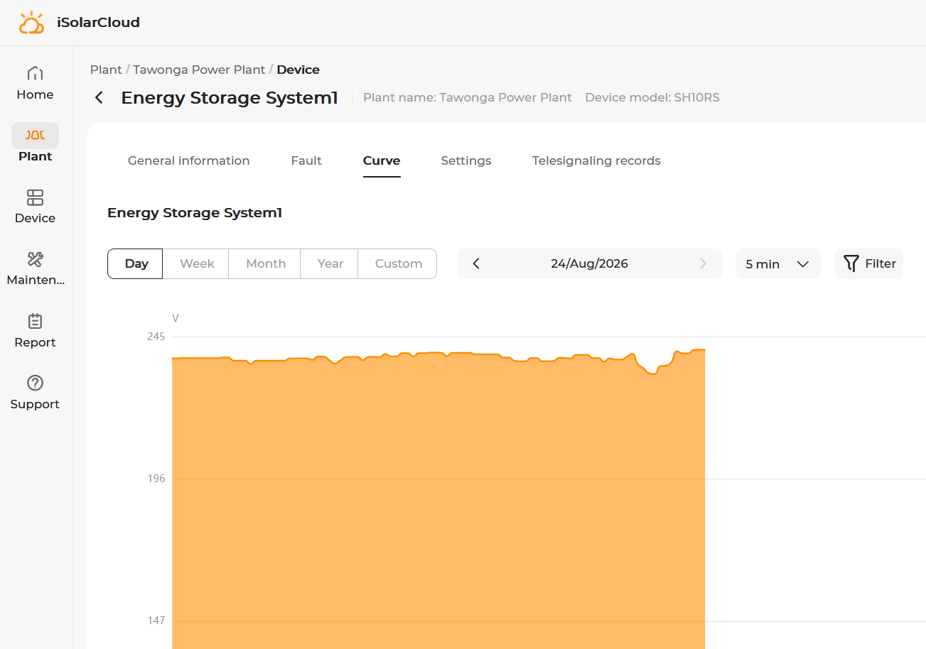

I also think you may still need to check your grid voltage during charging. You should be able to graph the voltage in IsolarCloud - see below (have to use the filter button to select voltage).
At 20-30% state of charge, a drop after 20-30 minutes is less likely to be ordinary near-full taper. The useful clue is which limit is active when it falls: battery charge-current limit, temperature limit, inverter AC input limit, or grid-voltage limit. In the monitoring app, compare grid import at the meter with inverter charge power and household load, and check each battery stack’s maximum cell temperature, cell-voltage spread, charge current and any derating or event flags. If grid import stays near 10 kW while battery charge power falls, focus on battery limits; if grid import itself drops, check supply voltage and loads. Save time-stamped graphs and event logs for the installer to review, and ask for the permitted AC charge setting and firmware limits for this configuration. Do not open live equipment.
