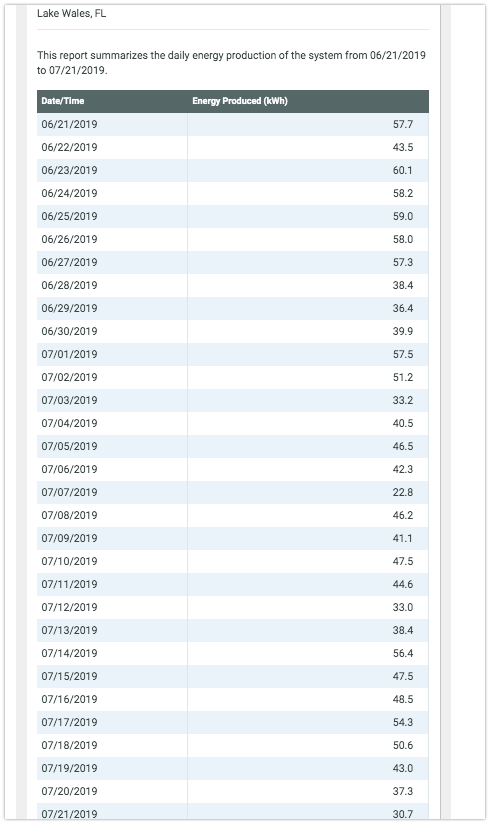

If useful:
Thanks again Alysa. Keep your insightful posts coming :slight_smile:
The Enphase Enlighten screen:
Apologies I did not intend to be unclear. I did consider using a public install for my example but I am more familiar with the one in the family and things like the shading of the roof. Yes I will say that generally speaking I am seeing their system producing great power in all seasons really. In fact its probably worse in the summer due to the more frequent and more significant rain events.
Didn’t know I could upload like this. I will have to say since I calculated what the size of their system, I was surprised they had so much. The highest I see is in 65-67 range in March and April actually. Much of the time it is in the 50s and 60s, lots in mid 40kWh for the day. I myself was quoted on what was labeled as a 11.7kW system which was 43 panels (300W) if I recall correctly (except Sunpower which was their 327watt panels, but they wanted to put in a larger system). I will say I am impressed with the sil’s production. Now whether any of this production is truly being clipped as noted by [dtbaker61] in Sunpower E20 327 AC vs 400W Maxeon 3 I am not sure yet, since I haven’t tried to calculate the numbers and double check.
