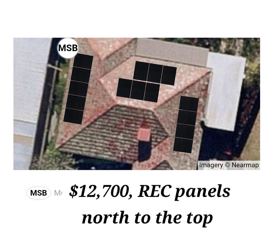

I’d have panels on the north, east and west facing sections of roof. The north face has some shading from a large street tree, particularly in winter.

6.9kw system net price $12,709
REC alpha pure - rx series panels (460AA-PURE-RX)
Enphasr IQ8X-80-M-INT (5.7kw inverter power)
