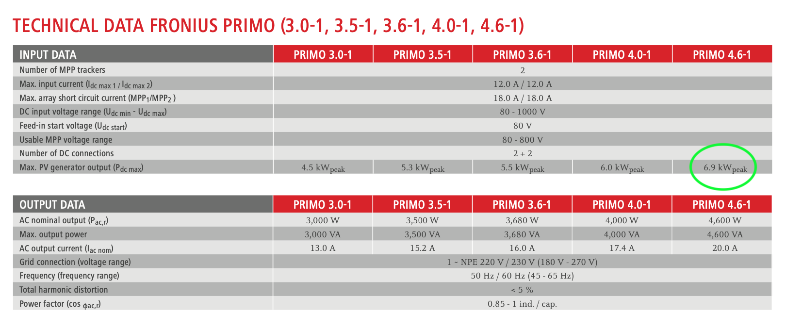

“up to the size of your inverter” could potentially be a deal breaker, but in reality the DC size of the inverter is 6.9kW, as shown here:
So while the inverter output “size” is 4.6kW, the input “size” is 6.9kW.
Your system would comply with relevant Australian Standards, and they also get more specific in the last section (“you will lose eligibility if you”):
- add extra capacity (i.e. panels) which exceeds the rated capacity of your system’s inverter
You won’t be doing that, so there is nothing I can see that specifies you will lose your eligibility.
I would bet that you would be just fine, however I am not going to tell you definitively either way, because I’m not a lawyer. I hope that helps though.
