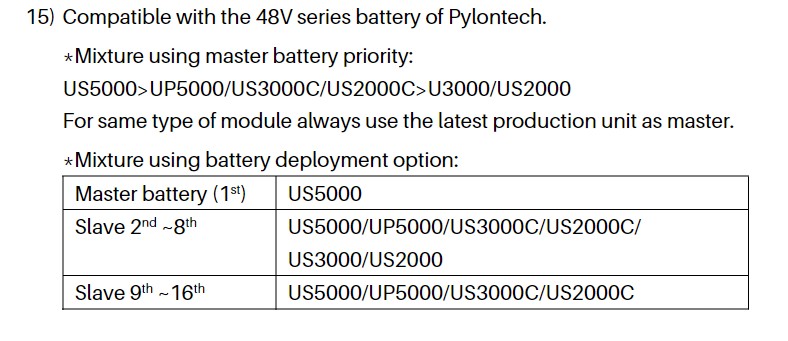

I was able to find some compatibility guidelines in the Pylontech US5000 manual.
When there are US3000C and US3000B in the system, you must use US3000C as the master battery. In addition, since US3000B only supports up to 8 in parallel, when the number of batteries is more than 8, US3000B (and the same for US2000B) should be set in the 2-8th position.

I was able to successfully upgrade an existing system that used 4 older US3000C batteries together with 6 new US3000(B) batteries. (Total of 10 batteries)
The first two batteries, including the master, were US3000C, then the next 6 batteries were US3000(B), and the last 2 batteries were US3000C. :+1:
Note it didn’t work when we tested the first 4 US3000C batteries and the last 6 batteries US3000B. The last two batteries (9th & 10th) must be US3000C.
